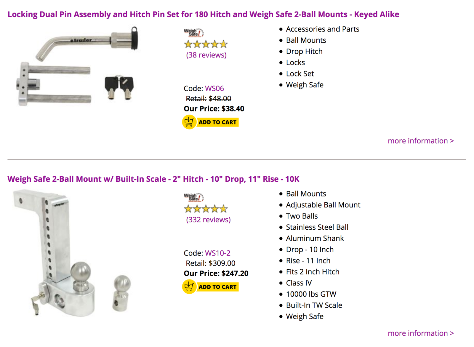

Just bit the bullet on a new hitch. I've got a handful of hitches already, but none of them have enough drop to level a trailer. I've been watching this one online for awhile now and the only price I've ever seen for it was $309. Etrailer must have this as part of their Black Friday special as today the price came down to $247. Still more than I ever wanted to pay for a hitch.. but with any luck this will be the last hitch I'll ever buy for this vehicle.

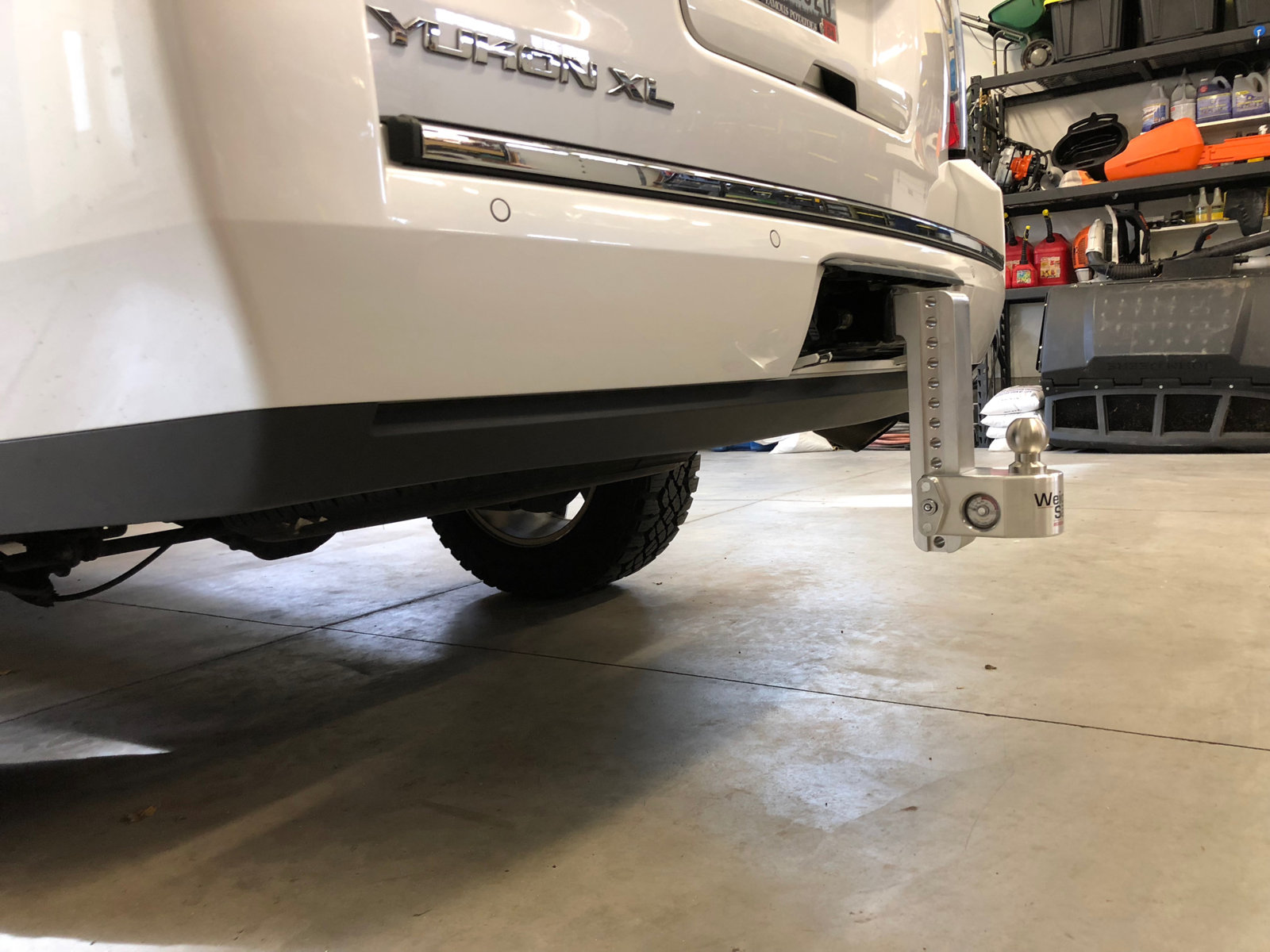

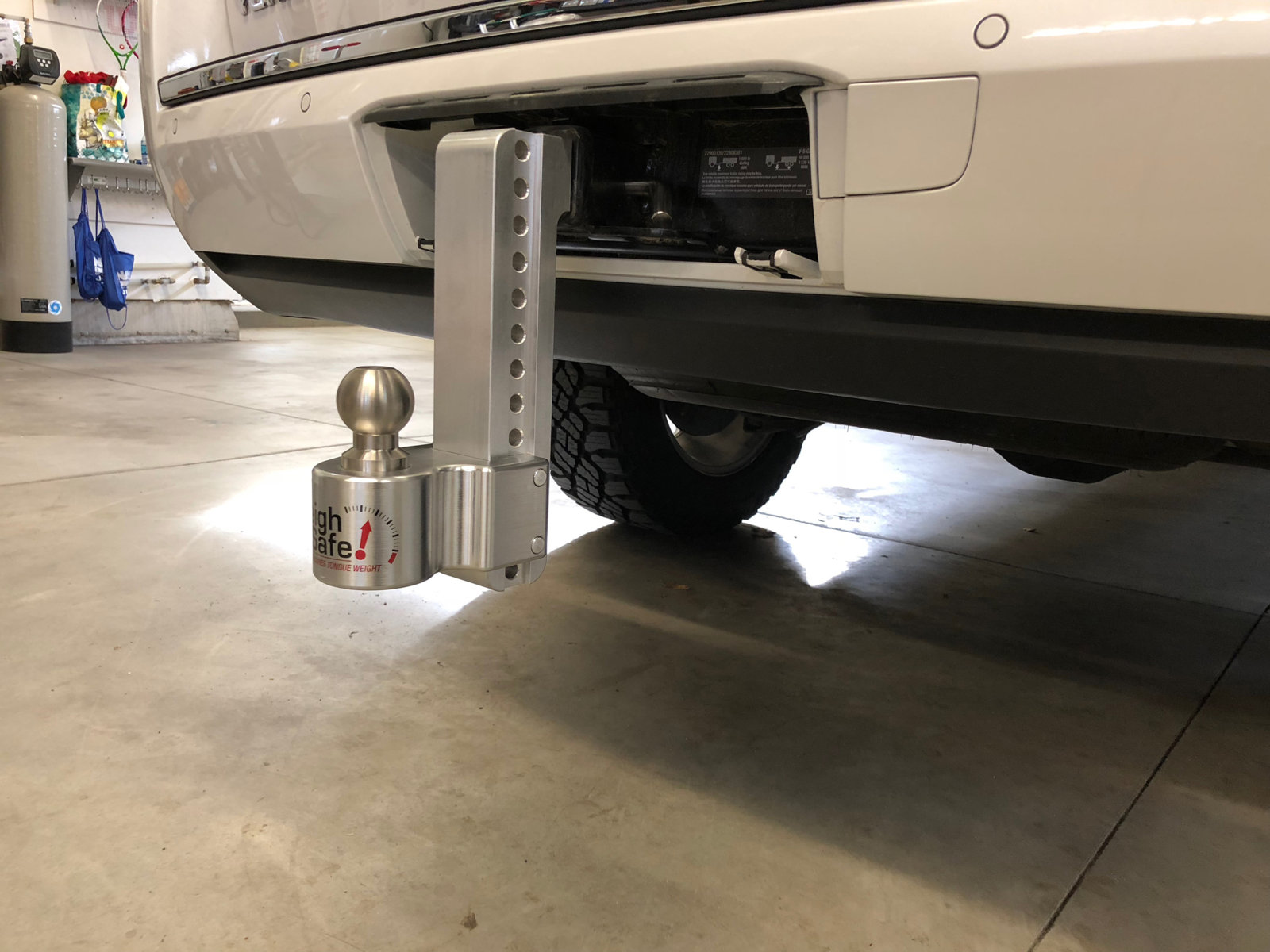

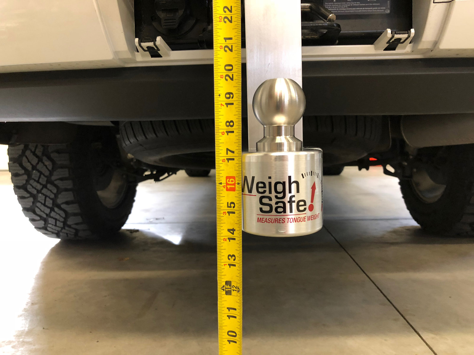

I got the hitch yesterday and did a test fit this morning. This is exactly what I was looking for. Fit and finish is amazing and looks to be extremely well made.
Added bonus, the box it came in fits perfectly under the floor in the rear cargo area. Always ready for a tow.
