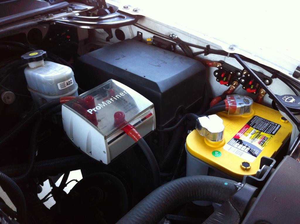

My issue is that usually when at idle, after driving for about 2 minutes after starting it up, it will trip the 200 amp circuit breaker and render my vehicle as useless as a Bait Car. This breaker is in line between the accessory battery and the main OEM electrical/fuse system. I have disconnected any other accessories to narrow it down, but I'm still baffled as to why it seemingly randomly trips. Any suggestions???
To save time, here is what I've eliminated as potential causes:
Overloading Of Circuit (draw)
Heat
Vibration/Loose Wiring
This is the 2nd breaker, so I doubt it's a bad breaker. The first was a generic 250 Amp and it too would trip, but less than the Stinger 200 Amp.
I'm thinking the alternator is going bad or is under too much stress with 2 batteries. The dealer said there were no codes associated with the electrical system. The other possibility is that the ProIso250-1 is malfunctioning, yet it shouldn't be able to create any extra power than what the alternator gives it.
Am I crazy? Or is giving a 200 amp breaker over 200 amps the only way to trip it? If so, how would a 160 amp peak alternator create over 250 amps at idle?
Here are some pictures for you to get an idea of what's going on here...
