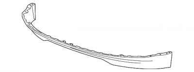

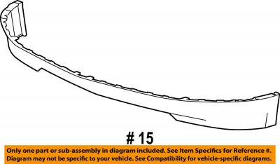

We just finished putting on GM Part # 23365760
It is the Lower Deflector that comes on Tahoe PPV. it is about 1/4 of the length of the stock piece.
It's a small mod but I believe it has changed the look on our suburban quite a lot, we like it.
I got it at, for 281 plus shipping
https://www.gmpartso...lector-23365760
The main reason was to gain ground clearance, for these off-road times, like when parking at a mall to clear curbs smile.png
Also already helps on steep driveways and coming out of parking lots...
The removal of the old piece and installation of the new one was quite simple. Remove some bolts/ torque screws, pushing down some clip, partial removal of front wheels liners.
I can't comment on any decrease in MPG on highway, as we use this truck in town.

I should add that the idea of doing this came to me after reading a while back a post on this forum where someone suggested to take a Tahoe PPV vin and call a dealership to get them to find me the part number.
If anyone would like to order, be aware that nobody stock these and they are special order from the chevy.
It took about 2.5 weeks for me to get it.
