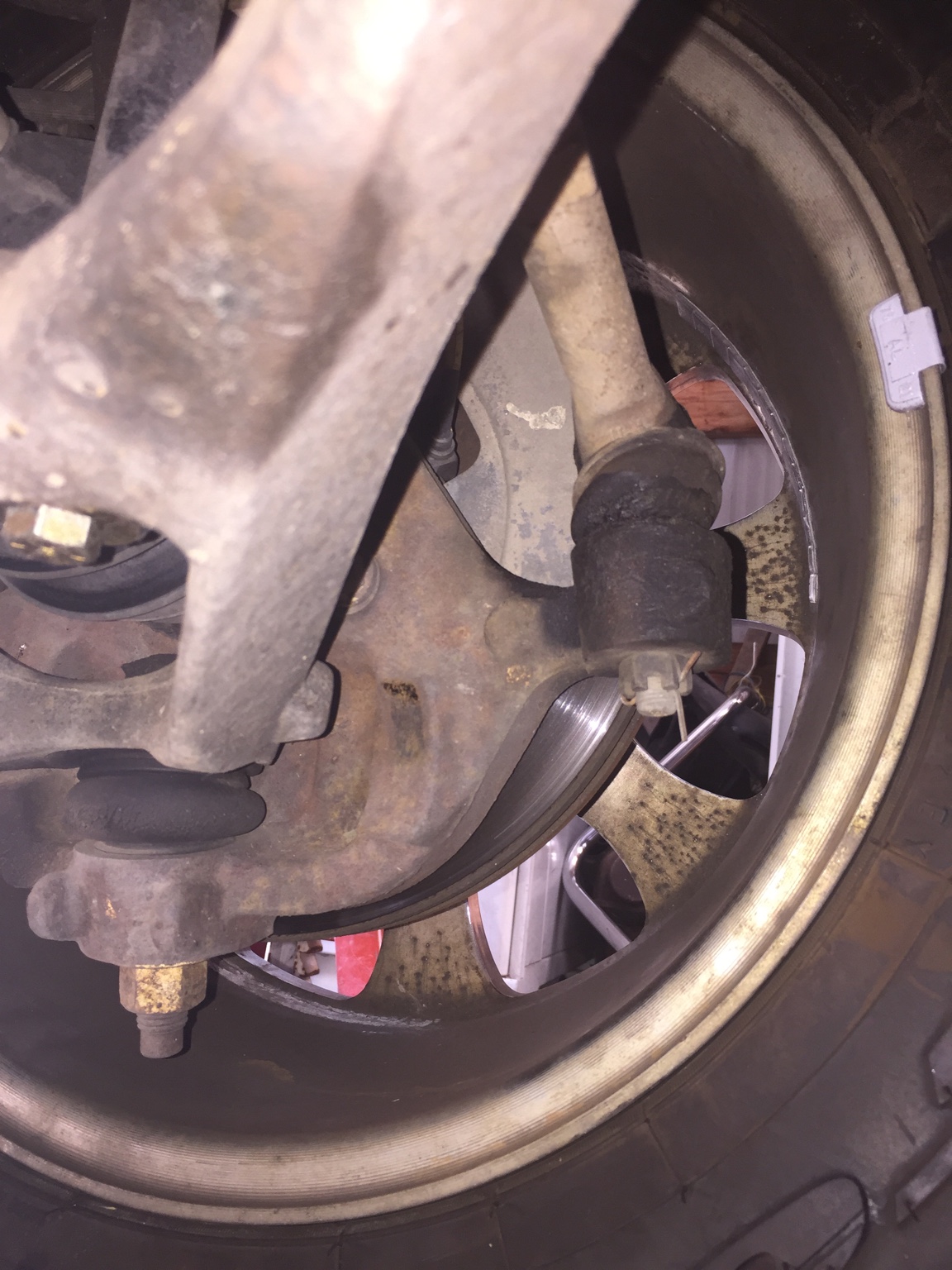

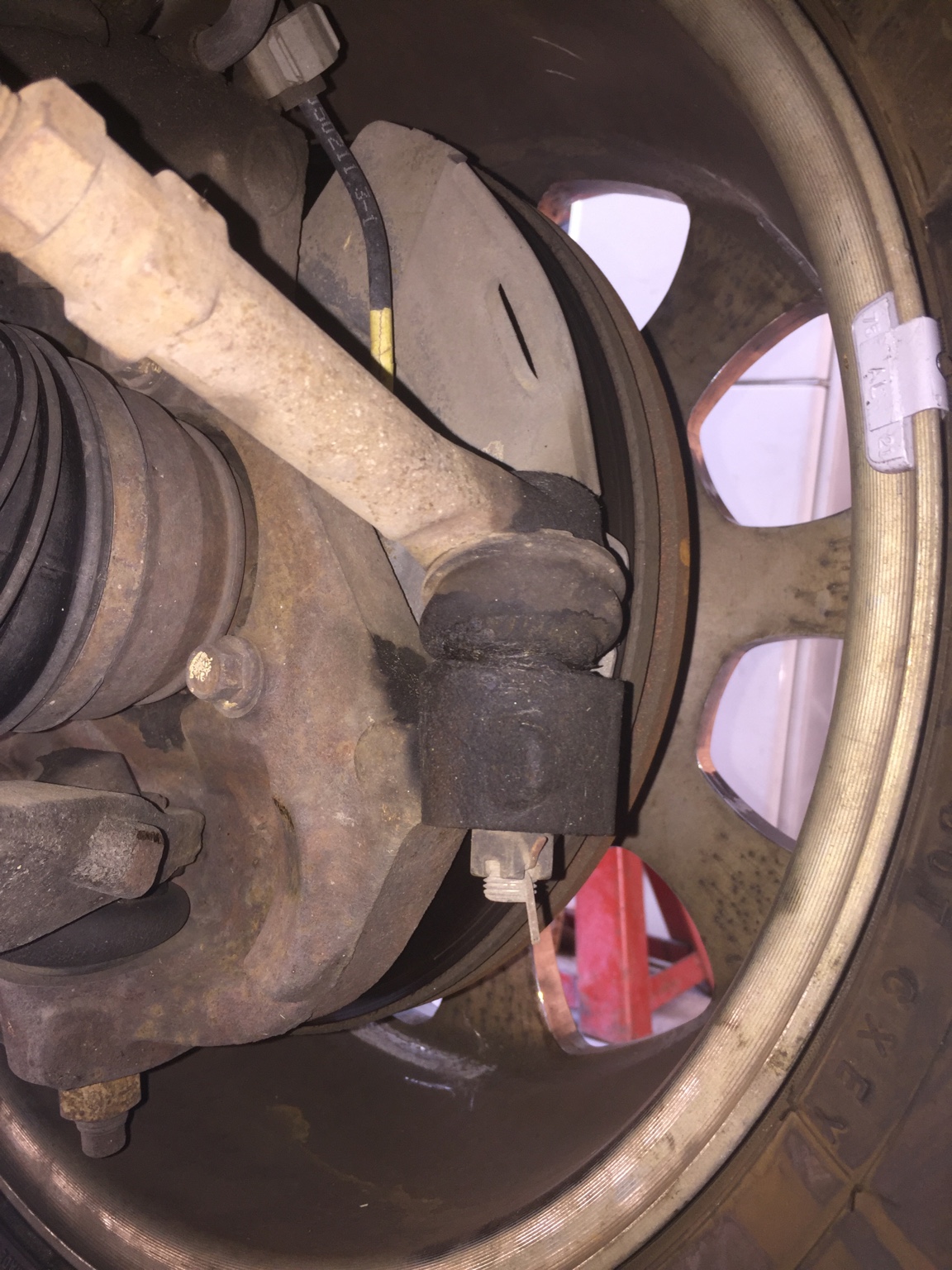

So I'm getting pops on turns and started looking under the truck and saw this. I'm pretty sure they aren't supposed to be that stretched or turned like they are.
Come on Suspension Guru's. 84f0fc96333ab2e3c595937251feff05.jpg6853bcc7600cdbf7bb2db01bcd91d2fa.jpg

Looks can be deciving. Shake the wheel side to side. Can you feel movement in he inner or outter tie rods? Or if you stick a pry bar under it and push up, is there play? Wheels off the ground when checking.

Stuck a 2x4 under the tire and it sorta has a hint of play up and down, but the side to side it moves the entire center link, so it's not "tight" there.

Under the tire and play up and down sounds more like lower ball joints.

Yeah I figured those were shot already, all cracked. The uppers are really bad but don't have the 550 for the Cognito UCA's yet. Plan on doing the Tie rods with the big ass Rare parts ones, just wondering if it is time. I lifted exactly a year ago.

If you're lifted, then it depends on how you did the lift that determines how those tie rods should look. But like mentioned earlier, looking isn't a way to check them. And if you're doing UCA's, it wouldn't make sense to do the tie rods first and have to do 2 alignments anyway. Just do it all at once, along with Pitman arm, idler arm and bracket and lower ball joints.
