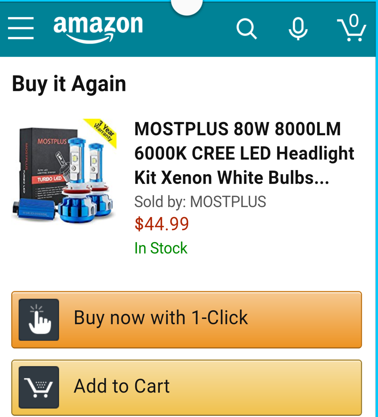

Second... The lights. Just go on Amazon and look up MOSTPLUS 80W 8000LM 6000K CREE LED Headlight Kit Xenon White Bulbs (H8/H9/H11). . They are as bright as my CTS-V's.. and any other luxo brand I can think of. Cost me $50 and took me a blazing 10 minutes to install.

Was there any modification to the housing needed to install those bulbs?
Not a one. Biggest pain in the butt was taking the airbox out of the passenger side. That was 7 of the 10 minutes lol. Also make sure that you disconnect the negative cable first. I didn't and threw a code even though the vehicle was off when I unplugged the air control module
Were you able to re-use the dust covers?
Where did you mount the driver for the lights?
Any pics? Seems like a good alternative to HID!
Thanks!
Thanks!
I can take some tomorrow. But I did zero mods to the covers. The driver literally fits inside of the dust cover. Just tucked it in and covered back up. No issues at all. Seriously. If U opened my hood and looked U would never even kno I changed a thing til U turned on the lights and lit up whatever was in front of your vehicle. Again there are no modifications done to covers and the brightness is on par with every hid I can think of... These are LEDs so it makes sense

Sorry it took me so long.. been busy with work. Anyway... here are pictures of how the end result looks under the hood. It is like this on both sides
Open (see the driver and bulb.. along with cabling inside)
20161025_152222.jpg and then closed
