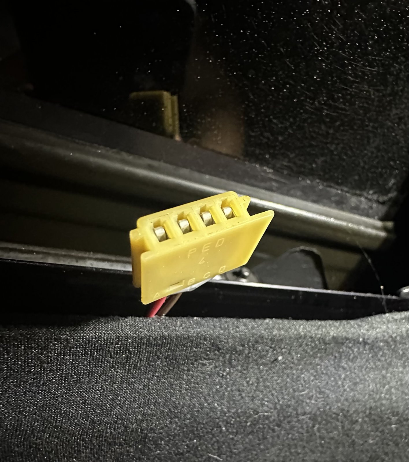

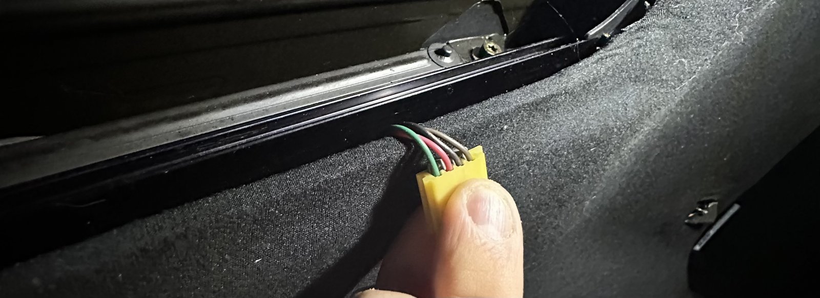

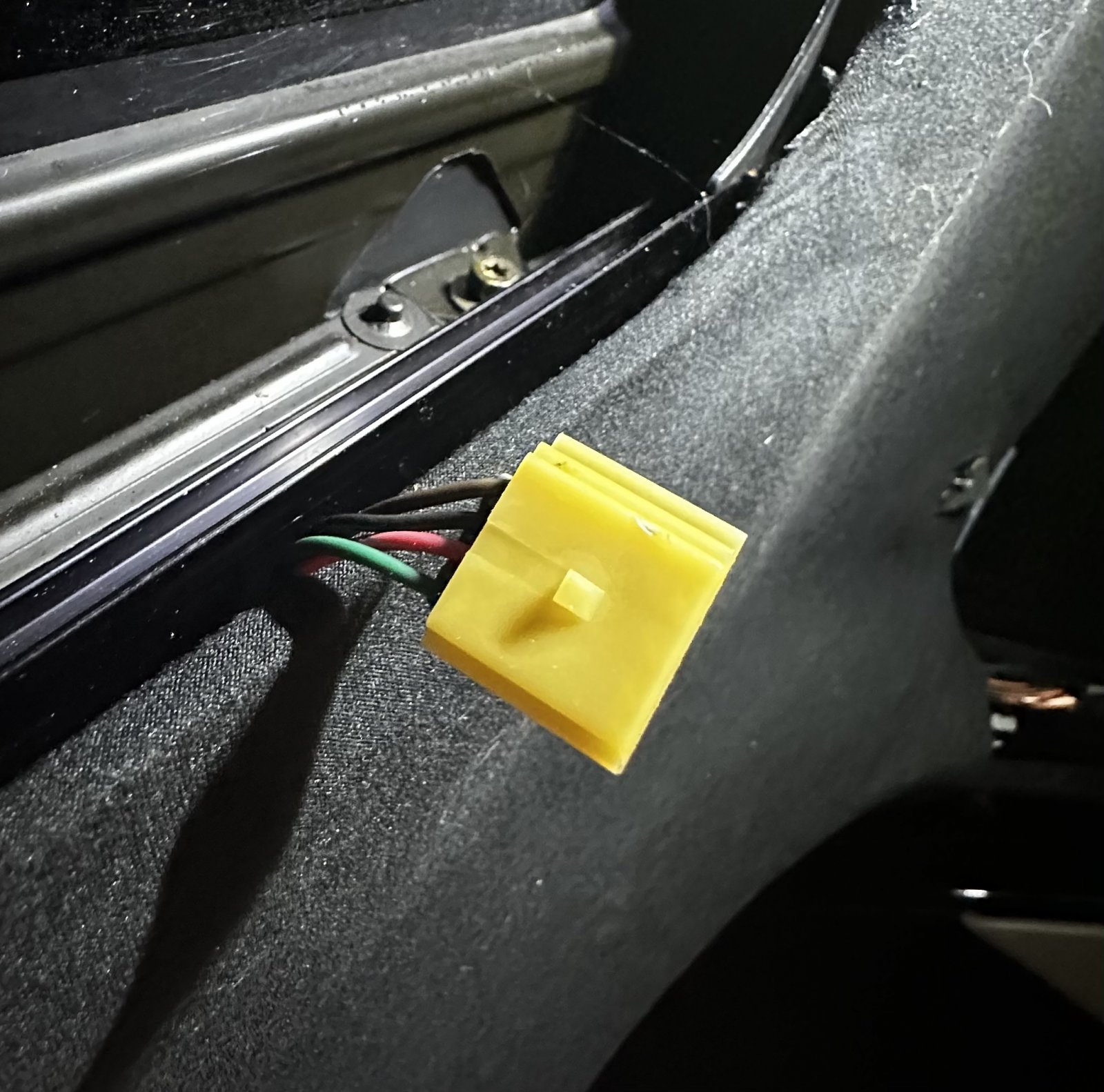

So I decided to reupholster the headliner in my 2002 Chevy Tahoe Z 71 and that part was successful but now I am trying to reinstall the headliner and I’m not quite sure where all of the wiring harness is plugged back in at. I seem to have them all plugged in, but the lights on the interior don’t work at all and I have one remaining harness that I’m not sure where it plugs in at. Please help.

Where is that located on headliner?
It’s a short cord that is taped to the wire for the front driver side sun visor. It just reaches the opening for the sunroof barely on the drivers Side.

Guessing... cabin air temp sensor (if it has one) that's in the headliner right above the driver's left ear?
Does wire go towards headliner console. If you look at 42 second in video in link shows two wires at that location.

It kind of does but I watched the video and none of the wires looked like mine to me

Changing a fuse fixed the sunroof and the interior lights. Never found out where that harness goes I guess it isn’t important. Everything else works now.
