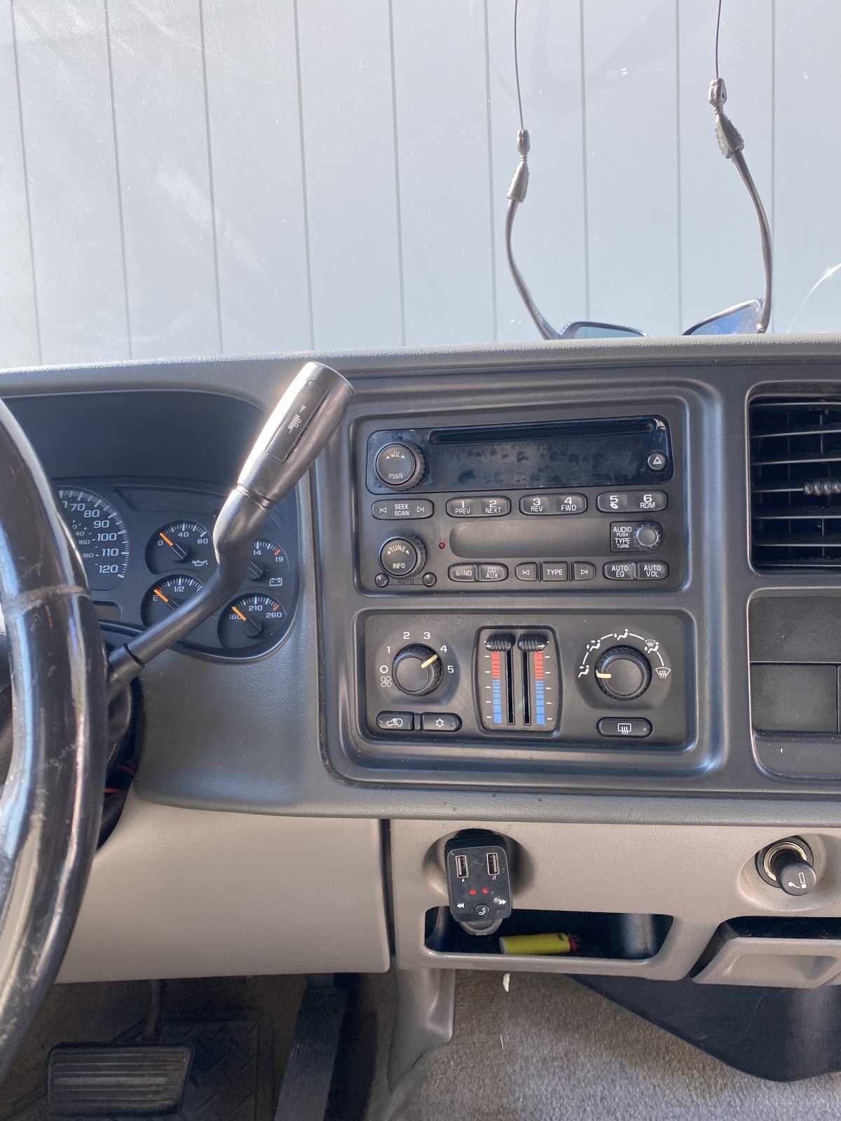

Ok so my 05 I just got is a LT the only problem I have with it is the passenger side speakers are louder then the drive. I’ve don’t swapped them around to see if it might of been the speakers but it still did the same thing even after swapping them around at this point I don’t know what to do I’ve done tried to balance them out but the passenger side is just so much louder it won’t balance I’m just trying to get these to work long enough for me to save up for a whole system and dose the LT have the factor amp is dose not have the Bose system and has anyone else every ran into this

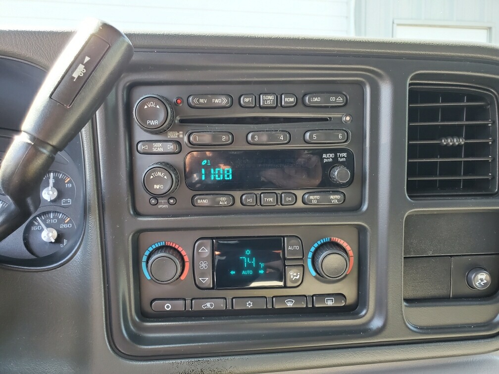

Welcome to the forum. If I understand you correctly, is the louder sound constant or gets louder when you drive? Post a pic of the dash radio set up. This is what I have in my rig:

Pics of the truck, please.
