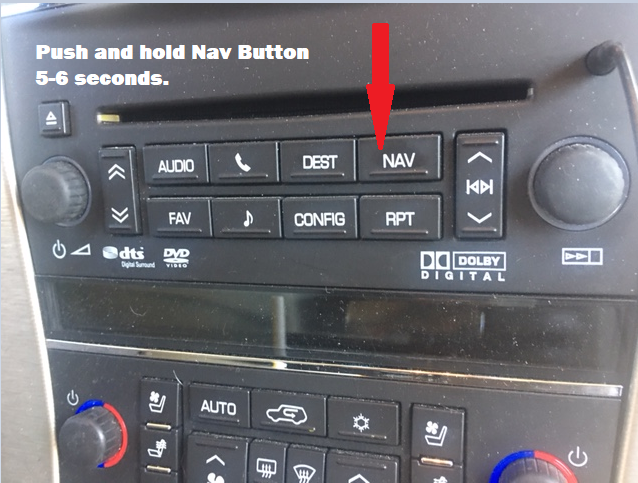

I went into the menu and turned off the screen display. The highway patrol shut down all eight lanes of the 5 Northbound in San Juan Capistrano. I do this to set my phone over the Navi display so it doesn't heat up the phone when I'm watching TV on it. When I went to start the truck the next morning, I got the same blank screen with the time on it again. Cool!
Two days pass and I'm trying to think of what hack I saw in the past that allows you to bypass this screen. You're supposed to be able to touch any button and have it come back to life. After looking on the interwebs I realized the secret screen hacks were for Tahoe / Yukon / Burb Navi units.
I guessed that one of the buttons held down on this Navi unit must command it go into diagnostic mode or manually come back. Guessed it on the 2nd attempt.
HOLD THE NAVI BUTTON FOR 5-6 SECONDS AND IT WAKES UP THE NAVI. No more removing and disconnecting the unit from its harness.
