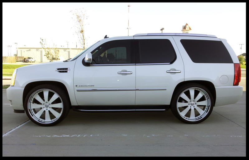

I have 2" front lowering spindles, Belltech struts with another 1" drop and 4" lowering springs in the rear. I run KMC slides 26x10 with 295/25/26 with no rub at all. I will probably go to a 295/30/26 next time.
