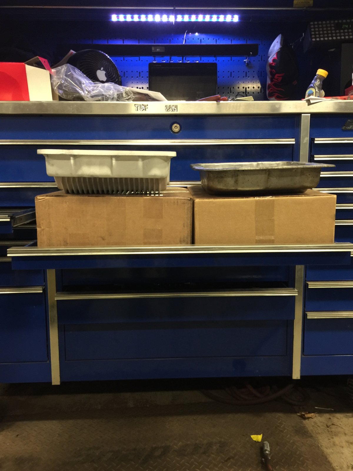

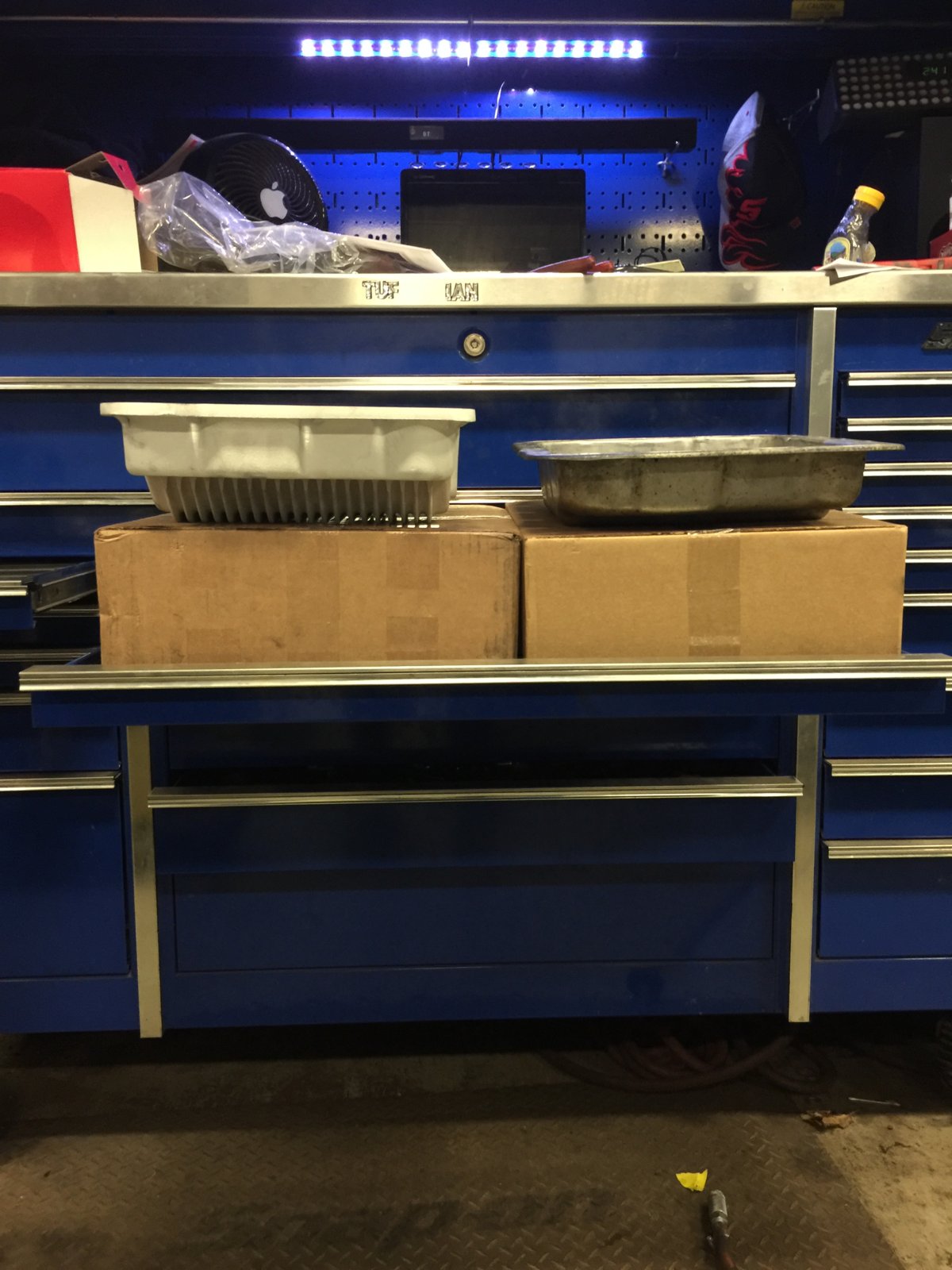

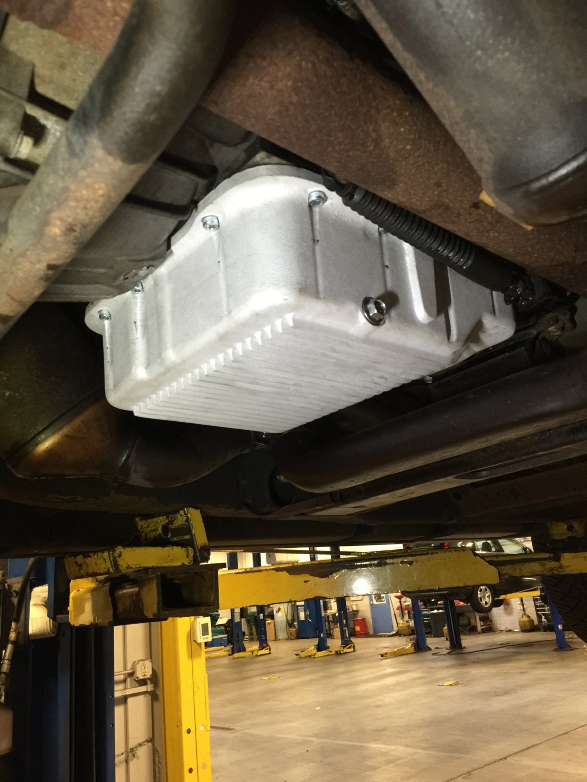

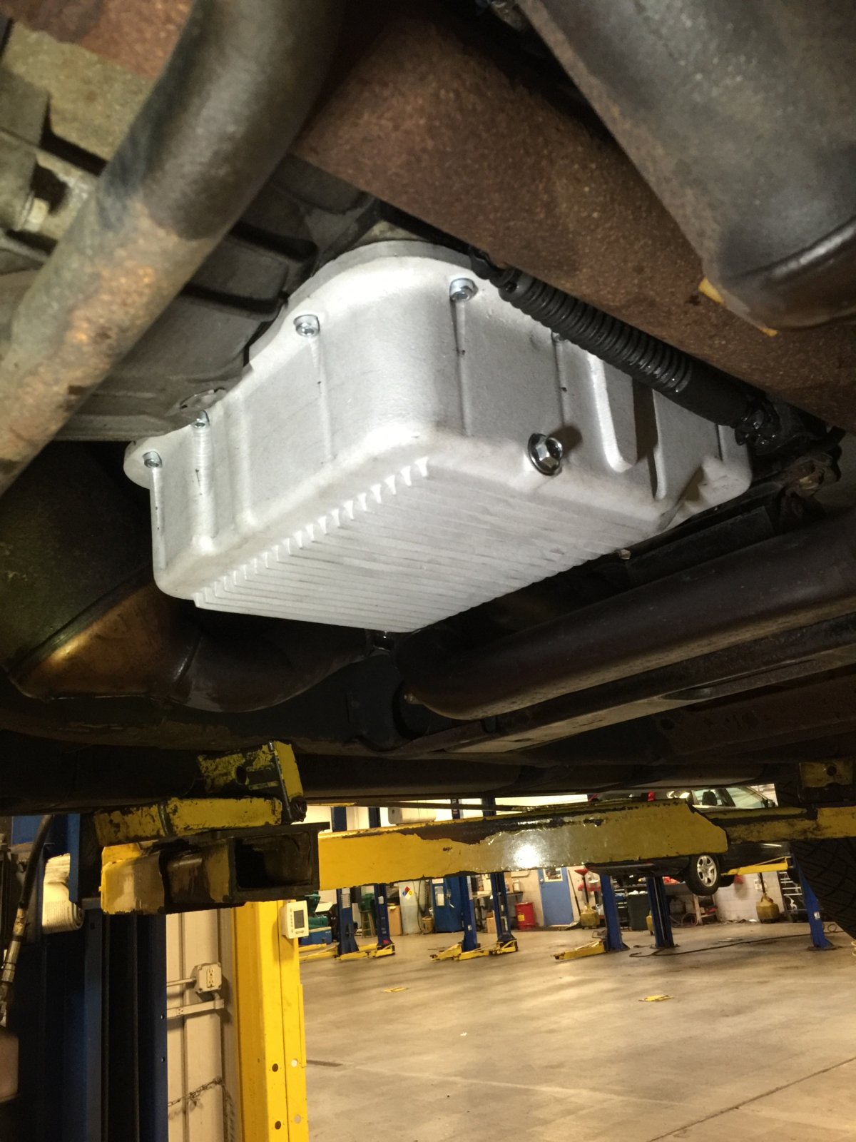

Make it easier on yourself for the future. Add a PML pan with a drain plug. It holds more fluid and is finned to help with cooling. It’s a messy job and can be a pain in the ass depending how you maneuver the exhaust.
I drain and fill 30k and the next time I do a complete trans service with a filter the next time trans is due.

I will keep that in mind when I decide what is my best choice. I just want to make sure I make the right choices when it comes to maintance on my Tahoe. Thanks for the help.
View attachment 189505 View attachment 189506
Link to the pan? Coming up on 100k miles myself and unsure of the service to the trans.
