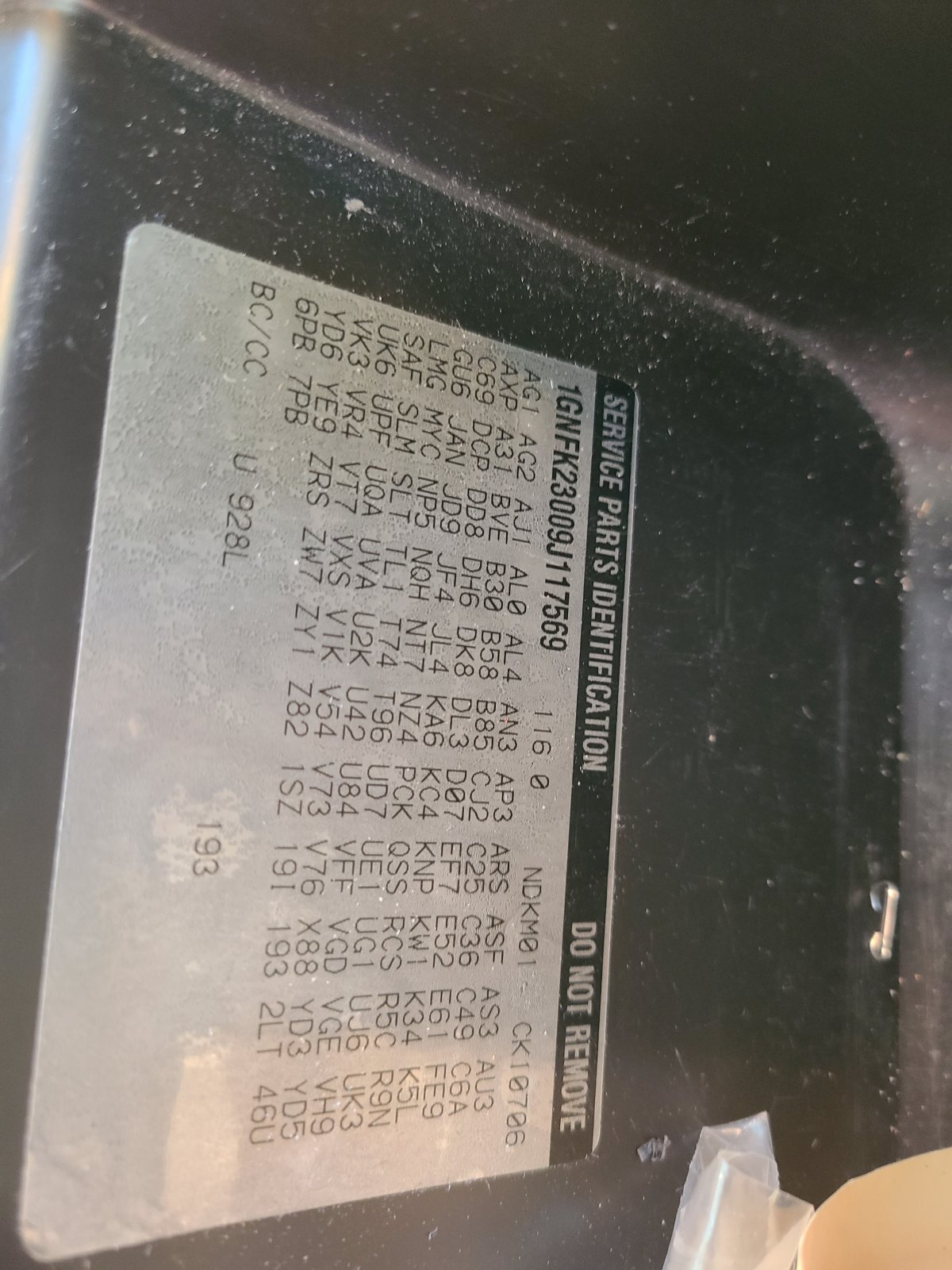

Maybe im going cross-eyed looking at it.
This is my rpo code sheet from the glove box.

Nicely equipped truck, got an LT with HD Cooling, external transmission cooler and engine oil cooler with 3.42 gears and the 2-speed transfer case. Just missing the G80 which was not an option to my knowledge on those anyway.
