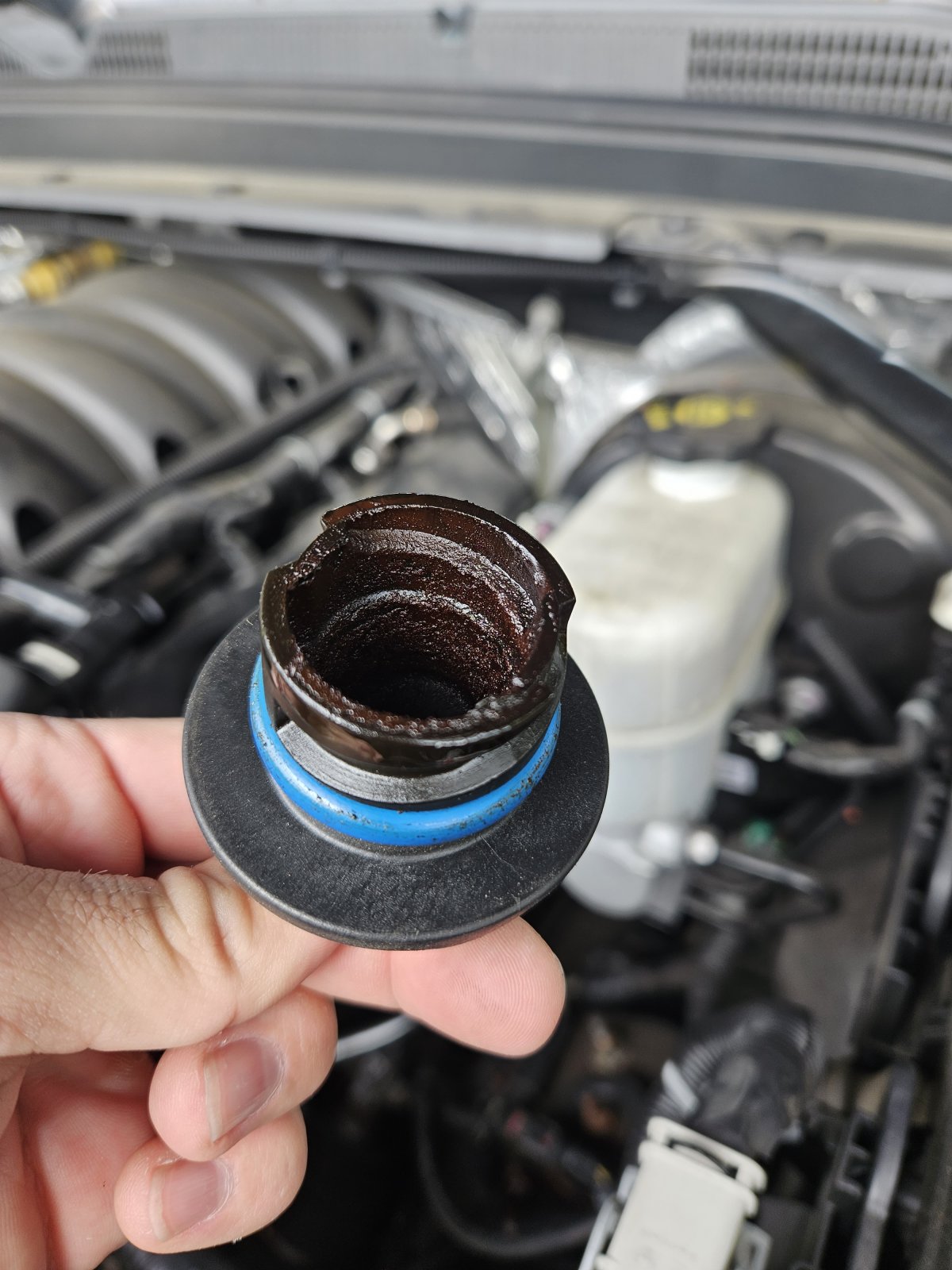

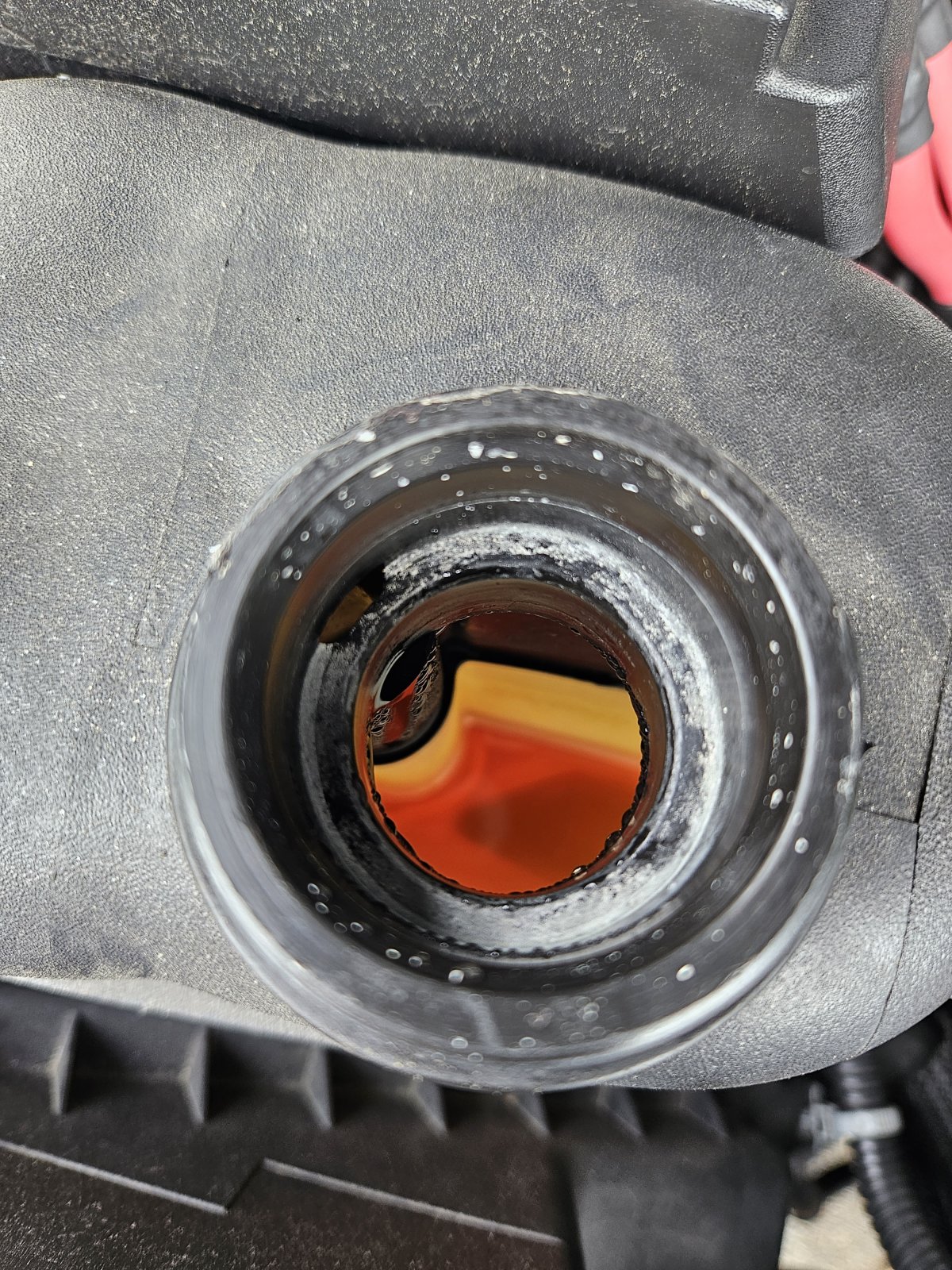

Pics of the coolant/cap, oil fill cap, and plugs. I would think what's on the cap is normal gunk from a 100k+ motor, not milky oil or foam.

So pil and coolant levels seem to be pretty stable since the last time I posted. Been trying to keep an eye on it.
Unless it's just extremely slow leak I vant figure out what it may be.
I will say the exhaust smells very rich to me, but I have no codes showing.

Your plugs are fine. Oil around the threads means nothing. If it were burning oil, the tips would have oil. Those look like a light ash color which is perfect.
You migh consider adding a catch can to the engine to help with total oil consumption.
Your coolant really doesnt show anything either.
The rough idle can be from a million things but without any codes you will never find it. Run some injector cleaner through it and a few tanks of high octane premium grand fuel and see if it runs any better.
