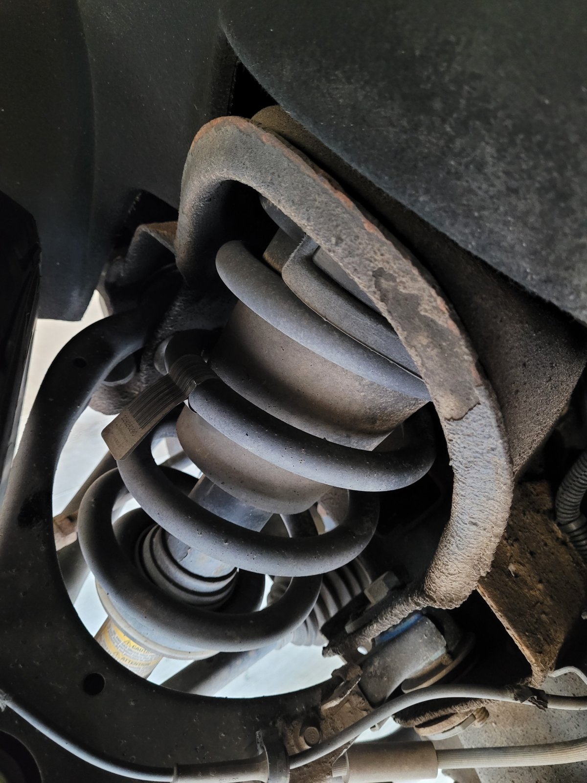

well, not as bad of an angle as i was expecting...that said, it appears to not have much droop
i am guessing ti is very close to the upper arm bump stop. typically, that make s for a harsh ride as most hits are initiated by a droop of the suspension

Agreed, huge impact on ride if there’s unwanted contact there during normal driving.
Pic of clearance between new UCA and droop stop bumper on drivers side, passenger is a bit less eyeing it up.
With the 2.5 suspensionmaxx they have you trim down that rubber bumper, I picked up new ones for the ReadyLIFT at full thickness. I thought with the level it looked a bit tight with stock UCA’s, looks like more clearance with the ReadyLIFT UCA’s. I’m curious what it looks like stock, I didn’t start paying attention until after I started making changes 39CBEAE0-D38E-48B0-B219-FDC829D0706E.jpeg
