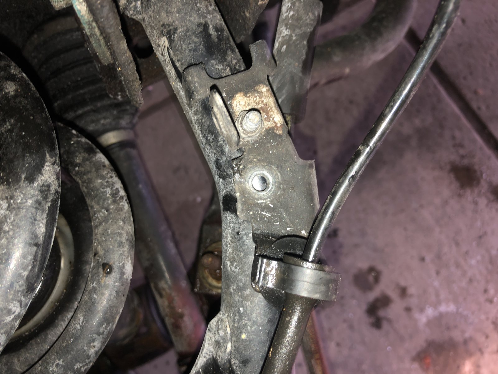

Made some tweaks today to allow the ABS wires and brake hoses to move freely during full lock full droop situations in the front, and abs full droop in the back. ReadyLIFT located the UCA brake bracket stud at close to the stock position and it didn’t seem quite optimal on my rig with the lift. First pic you can see the original brake bracket hole, drilled a new 1/4” hole where you see the stud/nut. Second pic shows the new situation at drivers side full lock right turn (heck of a lot better than my previous pic in this thread). Moved onto the rear, third pic twisted that wire clamp a bit, it was originally at an angle, and wrapped some electrical tape around it to fit into the clamp to retain it. I tried to oil and slide the grommet up, but that wasn’t happening.
