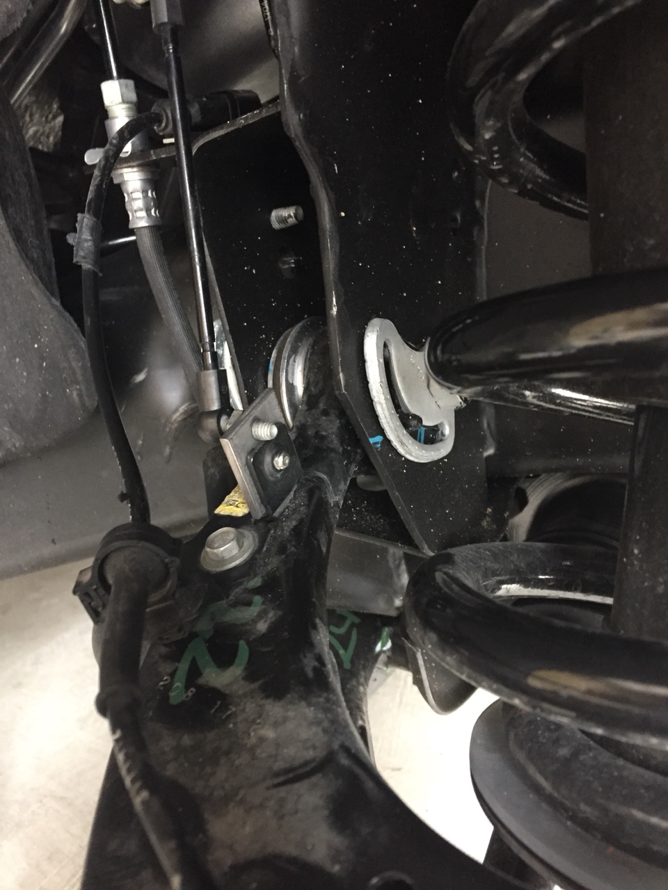

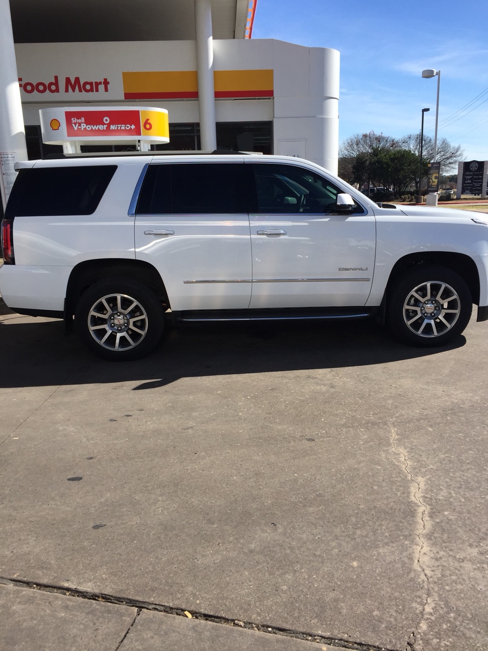

Installed the level kit this past weekend.
Pretty easy to install with hand tools.
A few notes:
Make sure both wheels are off the ground and disconnect the sway bar end links, if both wheels are not off the ground the sway bar will bind. This allows you to lean on the caliper/knuckle so you can get the spacer in.

Thanks for the tip! Looks great! Is wheel alignment required after installation?
Yes, you need to do an alignment and I really need to get off my butt and get it done!!

Thanks for the photos! I have been torn between the 1" and the 1.5". I think you have made up my mind. I don't necessarily want bigger tires. And I don't want it nose high when towing. 1.5 looks perfect.
