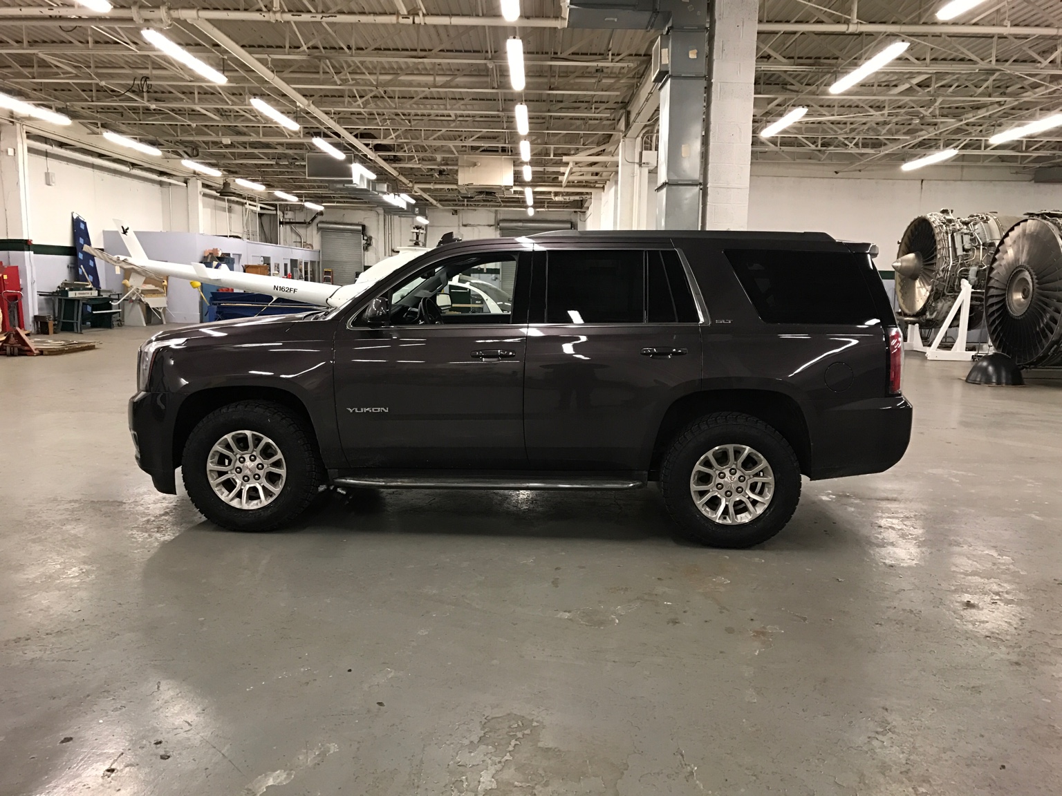

I've been also looking at whether a larger size would fit with stock suspension. Most of the discussions of larger tires involve some leveling, which I don't want to do. I am surprised that 275-70-18 works with no trimming. That tire is 33.2". Stock is only 31.6". Looking at the clearance I have when turning the wheel, it doesn't look like there's even an extra inch of clearance.
Agreed, seems like a rather larger tire to have on without any rubbing taking place. I love the look of it though, fills up the wheel well perfectly.

^That looks fantastic and just the look I'm going for. Any chance you have a full on side profile shot?

Excellent. Thank you.
How's the ride quality and road noise after putting those on? Any noticeable difference?

No noise that I can tell except on concrete roads a little sound not a deal breaker but the ride got a little bouncy in pot holes, after a couple days I was used to it.
