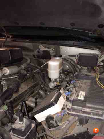

RESULTS:The Tahoe drives better than it EVER has. It drives straight and with the steering wheel centered. The steering is TIGHT! the first time I turned the wheel it felt like it was in 4wd. It took a while to get used to. IT STOPS on a dime. Seriously, the NBS master cylinder should be a must with bigger tires on an OBS. All leaks that were present beforehand are sealed. NO squeaks from the suspension. The old wheel hubs should have fallen off. I couldnt believe my eyes when I saw them afterwards. They would drop down by 20* if you were looking at them from the side!
