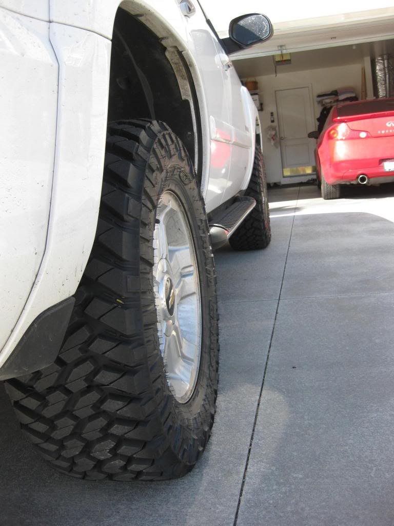

I agree with 2ELO about the 285's. I'm running 285/50/22's which are like 33.2 x 11.45 or something close, w/ a 2.5"/1.5" kit and they don't look "wimpy" to me at all.
In regards to rubbing, I don't know if there is added issues between the Nitto TG's like I have vs a M/T since the M/T's typically have side lugs and the beefier tread seems to stick out a little more than an A/T.
All I know is it seems pretty much all of us with a leveling kit and bigger tires have had to do some trimming thanks to all of the lovely plastic GM puts on these things.

Haha oh well you gotta do what you gotta do but that helps a lot, thanks. Your Yukon looks sick I'm kinda going for that look. But yeah that doesn't look wimpy At all. How does having those 22's affect the price of tires? Do you know which has better tread wear between the trail grapplers and open country m/t's?
