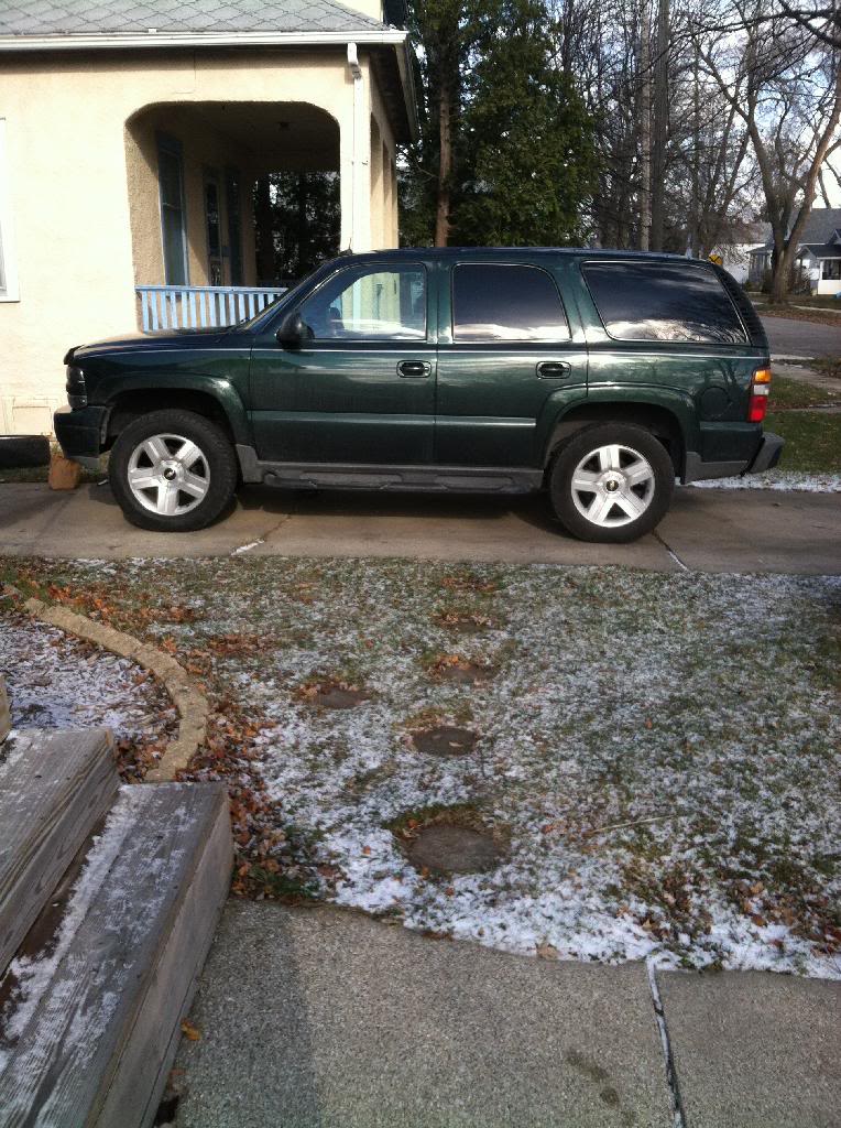

When I was stock height with keys in front I have 275/60/20 cooper zeon ltz with no rub at all on stock silverado 20s.this was like 4years ago.
