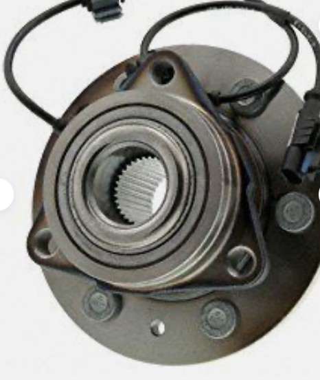

Left front wheel bearing is making humming sound. So I guess the wheel bearing is going....Is it necessary to change the whole hub or can I replace only the bearing? Thanks for your help.
We had an 08 Tahoe and over its life we replaced front wheel bearings 3 times. They are famous for that.

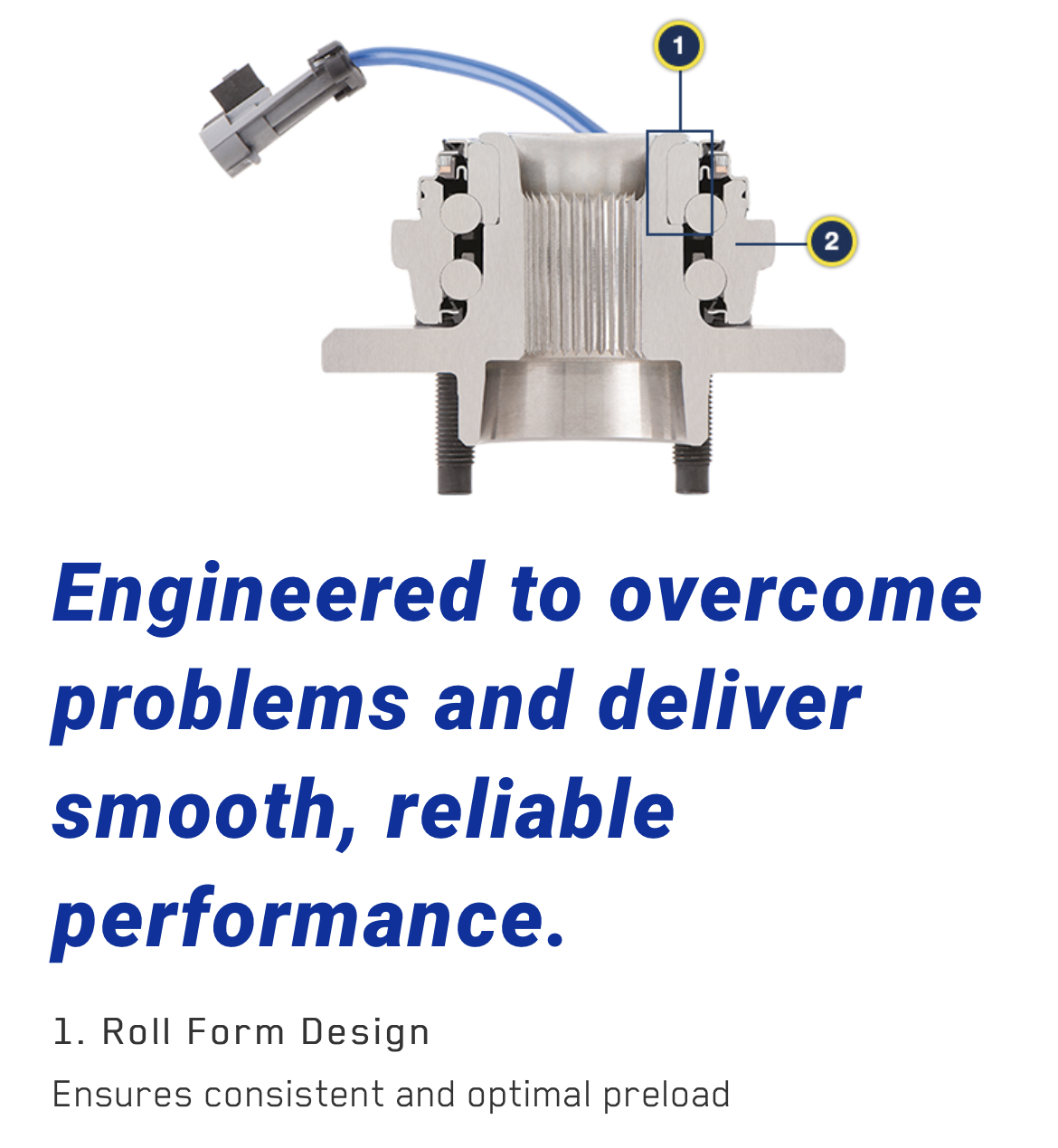

I know somebody here posted a cross section of the 4WD bearing. Trying my damndest to find it...
89Suburban
Bull in the china shop
Jan 10, 2013
15,826
44,634
SE PA
Here I found it.
