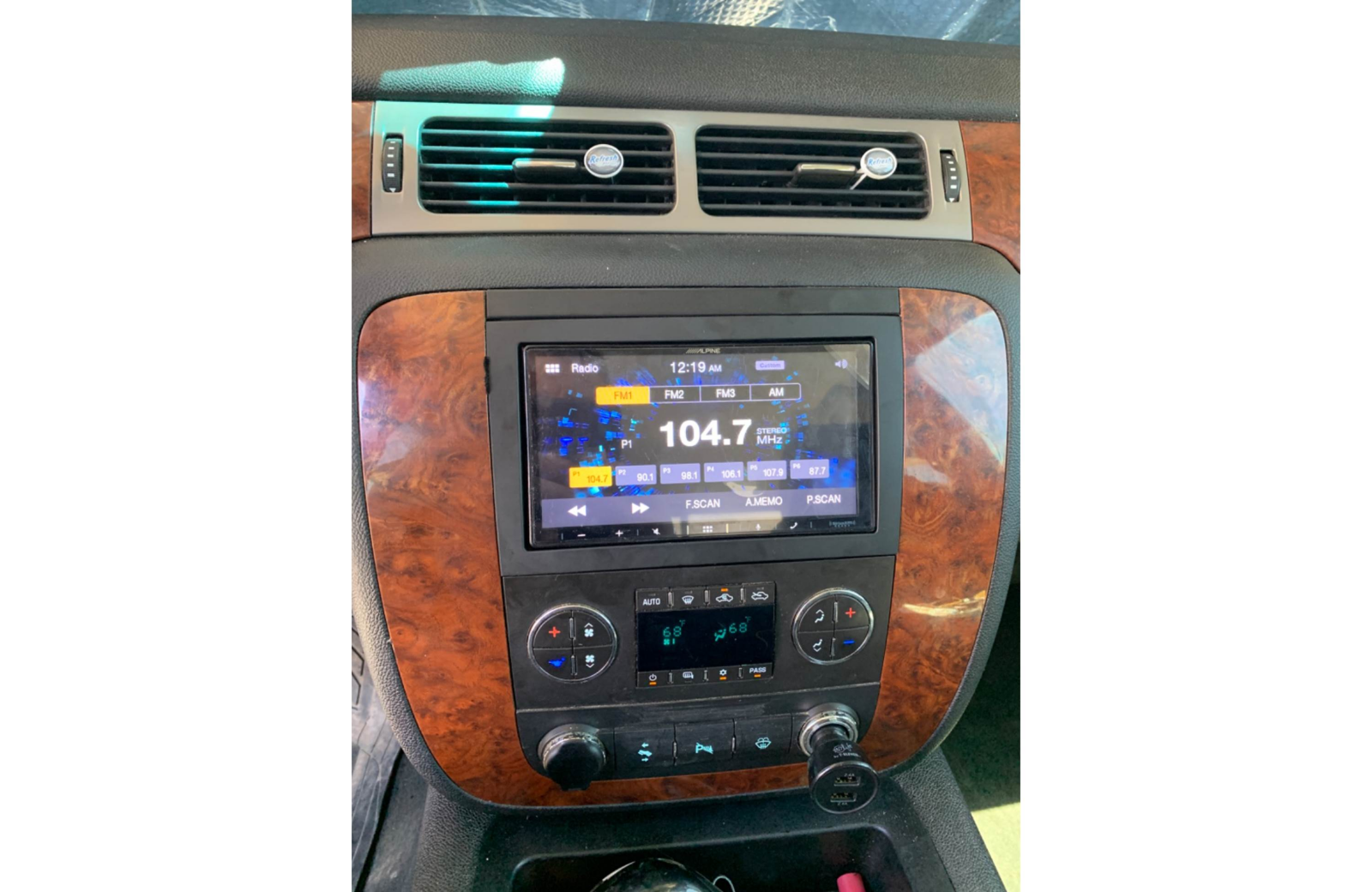

I noticed there aren't many options using the vehicle fitment guide. Are you guys just using a different face plate or something for other models?
Would this work in my yukon?

Okay sorry I am a huge newb with this, I only do engine stuff LOL
But since I revived my truck, I want the system to be a bit more modern with stuff like carplay. So that unit plus an adapter plate will basically replace what is in the red? So I will do HVAC through the touch screen only?
