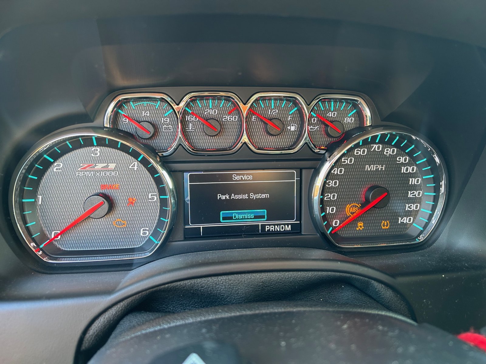

About 10 miles out, I noticed all the gauges were full lock left, reading 0. All of the sensors flagged alerts. Wipers, parking, ABS, airbags, etc. Center console had carplay on, and kept working. I thought that's weird, maybe I should stop and turn off the car, and when i turn it back on it will effectively "reboot".

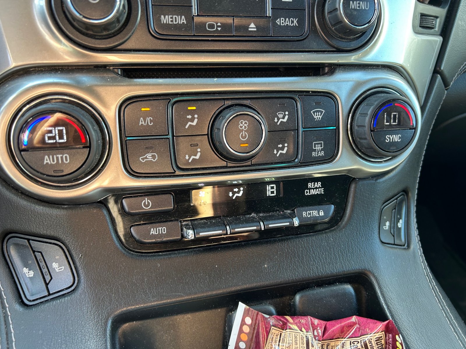

Tried to connect a cheap OBDII reader I have, shows 0 codes. Great.. Also notice the climate info is in Celsius? Weird.

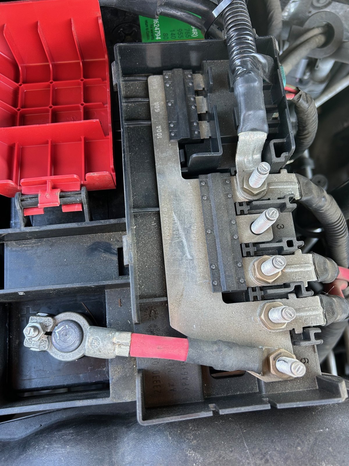

View attachment 448878View attachment 448879View attachment 448880
your first clue if you haven't fixed this already is you have no voltage, so that means one of more of those battery top fuses may have a took a dump or one of the cables connected to it are bad. or you may have a really bad ground somewhere, you need to get a meter out and start checking starting at the battery.

if you have key on, engine off and it shows 0 voltage then your issue is not the alternator, if you for some reason suspect it could even remotely be a bad alternator then simply unbolt the charge cable and try again. key-on, engine-off. you should see 12.xx on the gauge and thru the obd port with a scanner.
IF THIS IS THE CASE AS NOTED ABOVE (no voltage)
then go take your meter and check each of those fuse outlets on the battery top, each has a different rating i.e. 175a, 80a, etc, etc
if one of more of those are burnt (no continuity) then the vehicle may only get partial power, so you may have interior lighting but no power to the ecm, etc
those fuses are not serviceable you have to replace the whole unit and it runs about $120.
AND if one is burnt you need to figure out why, before you blow $120 by bolting up a new one and repeating the same end result.

depends on which sensor..... maybe post up a photo, the power on these k2's is split up from the battery top fusible link, so if one of those points burnt out you may see one thing works and other things no-go
found out myself the hard way when a audio amp I was installing was bad out the box and fried the system.....luckily the fusible link did it's intended job and nothing else was burnt up in the process.

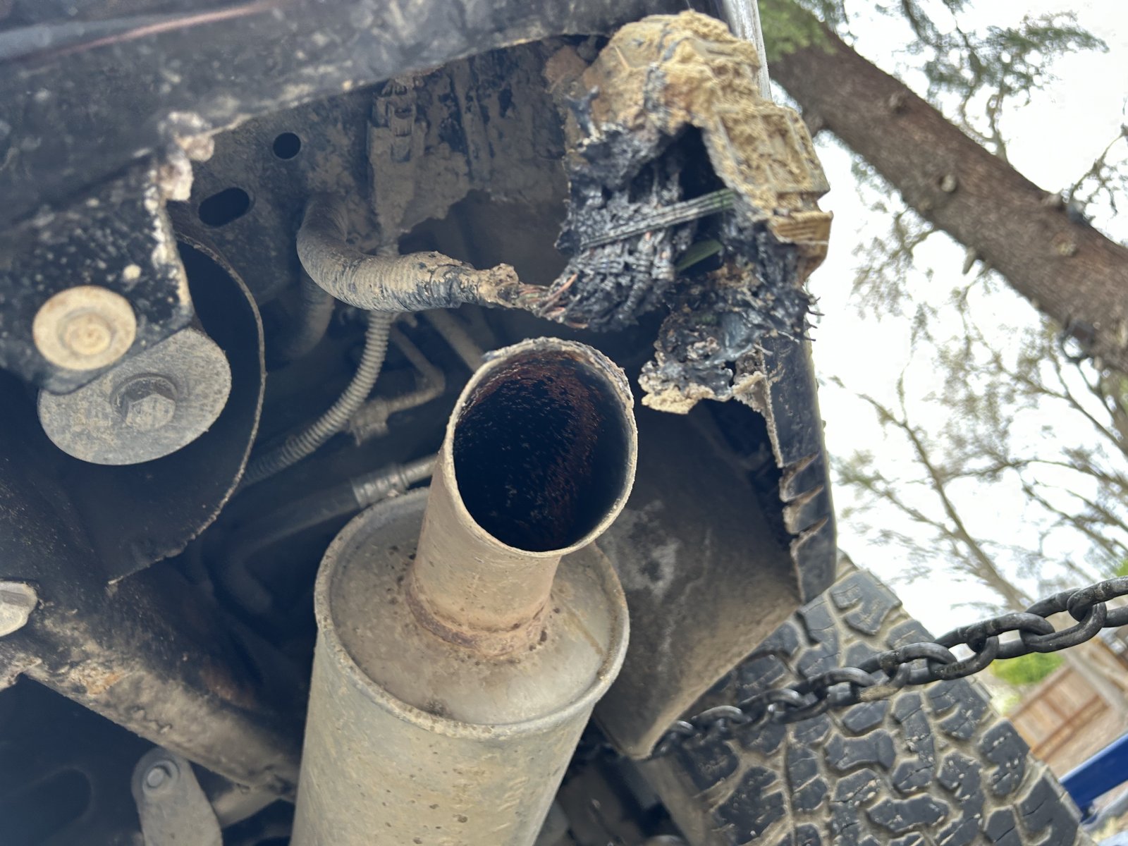

I did tell them that I just had the bumper replaced and I did see a cord hanging out the back rear the other day. But I wasn’t sure if that had any relation to anything.
The apprentice went back, got on the ground, and looked underneath and found that harness, only to realize that it had a considerable amount of melting.
Seemed pretty obvious that would be the issue, they towed it back to caliber anyway since they did the bumper repair I needed. They’ll probably cover it under warranty.
What is interesting is that? I probably drove this Tahoe for the last five years to my Duck Club and it constantly got mud caked in the same spot never had an issue though.
I am guessing that when caliber replaced the bumper that had a big dent in it, that they forgot to clip the harness up higher or something, and when I took it hunting again, all the mud splattered and it fell down - thus either catching on fire or being so hot that it melted being near the exhaust pipe.
Candidly, I was surprised that a wire harness that far back could disable the whole car. Interesting right?

that's pretty much a known defect on the k2's, the module/harness is held on by a FACTORY plastic bracket/clip, that breaks and then allows the thing to hang on the exhaust pipe and melt the crap out of it.
why there has not yet been a recall on it I don't know
