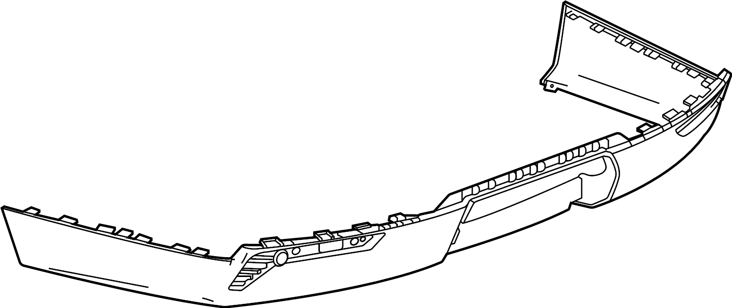

To anyone trying to find the part numbers for the rear bumper trim for dual exhaust if you have a Tahoe/Yukon part #84751055
If you have a Suburban/Yukon XL part #84751057 had this info confirm by dealership

I have a 21 Yukon xl trying to get dual exhaust i installed part #84751055 but didn’t fit its like 2-4 inchs short anyone know if it’s a different part # please help someone and I apologize if the answer is already on here I couldn’t find nothing thanks everyone
Here is what I found.
Bumper Cover (Lower)​
Part Number: 84751057
Bumper. Cover. Fascia. Valance.
Bumper Cover. Dual exhaust.
Fits Suburban , Yukon XL
Dual exhaust.

Definitely gonna give them a call in the morning to verify it will fit I dont wanna buy other part that won’t fit lol thanks for the info

Hello, thank you for the part number.
I have a 2022 Tahoe Z71.
Do you think this lower dual exhaust bumper will fit?
