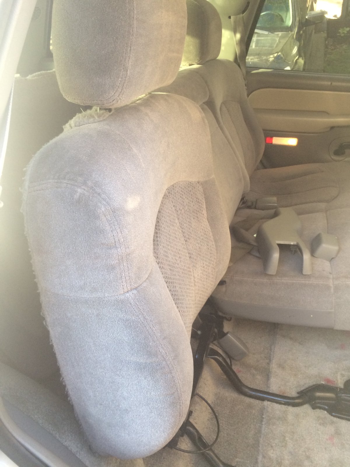

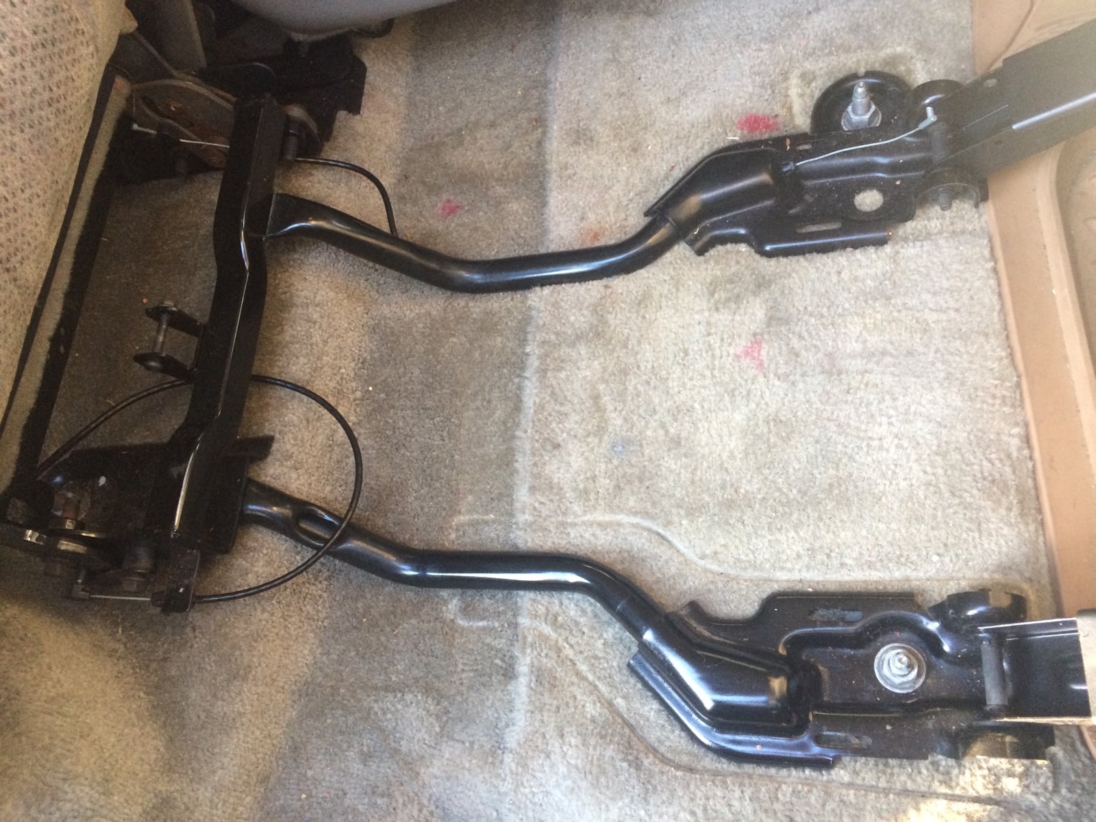

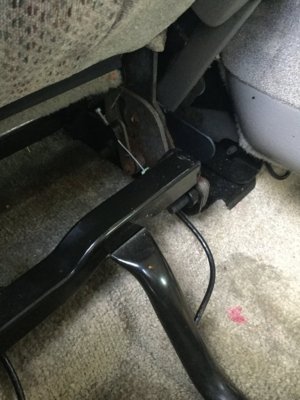

hello everyone, this is my first post.
My passenger 2nd row seat will not fully go back in line with the others. Any idea why this might be? See pictures.
54834FC3-7E10-42BF-B2AC-5393A07E6AC5.jpeg 2BCD5836-B359-41E6-B468-189545F5B820.jpeg 967514D2-535B-479C-8F68-341BD55F8404.jpeg
26,635
40,141
if its not being blocked by the seat behind it then you have something bound up or out of place, take a close look at the hinges and locking clips

it is definitely not being blocked by the 3rd row seat. It acts like this with or without the 3rd row in. I bought the Tahoe used, about a year ago, and it has always been like this. I will take better pictures of the hinges, and I have no clue what the “locking clips” are.

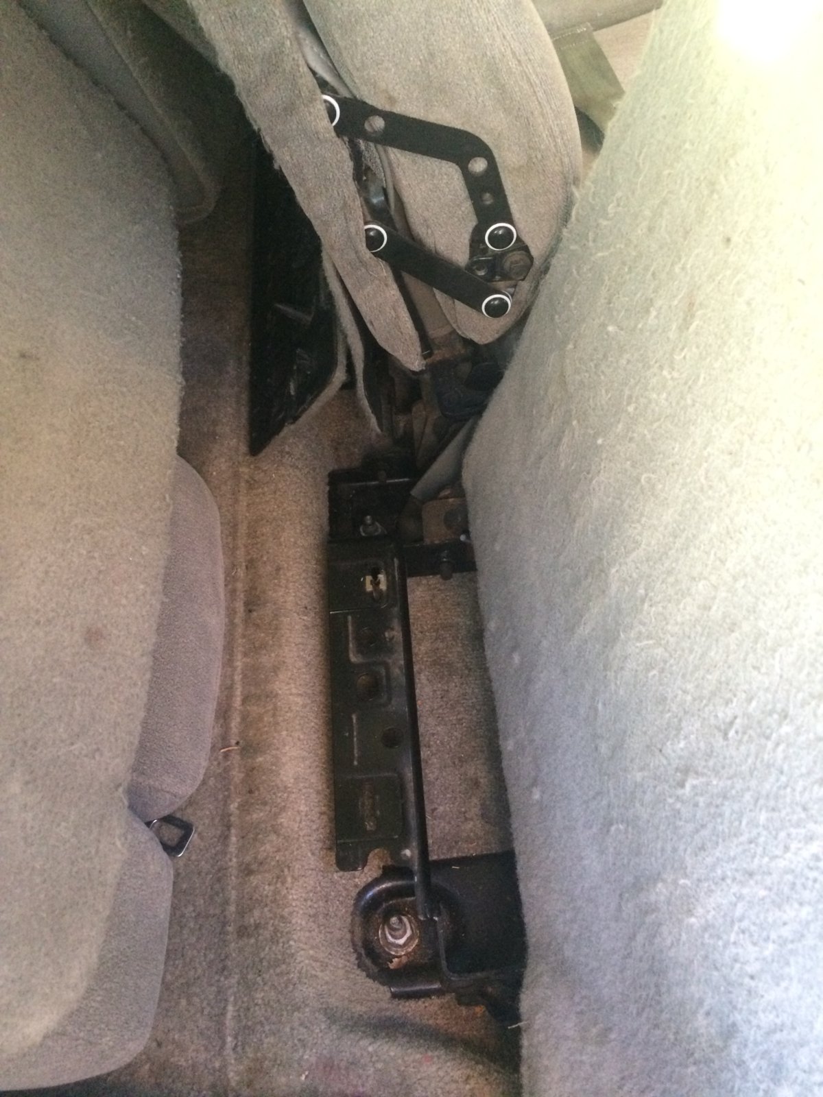

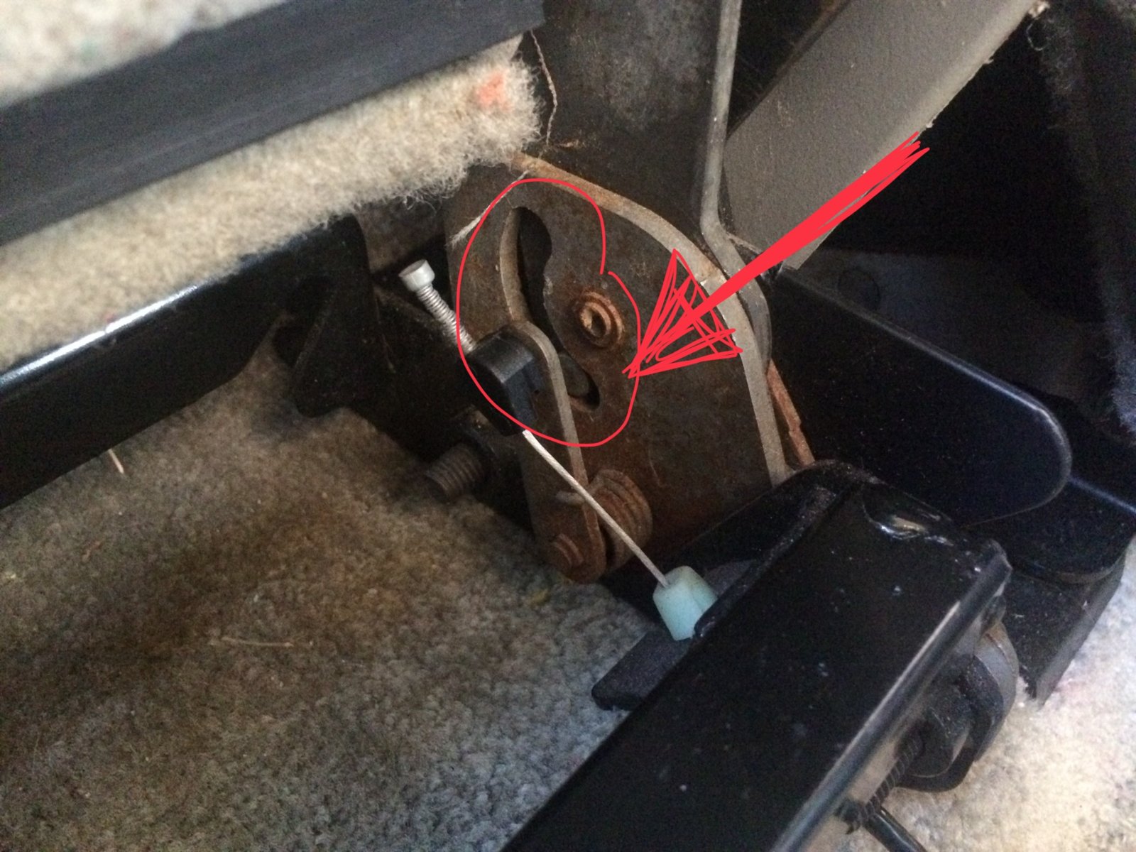

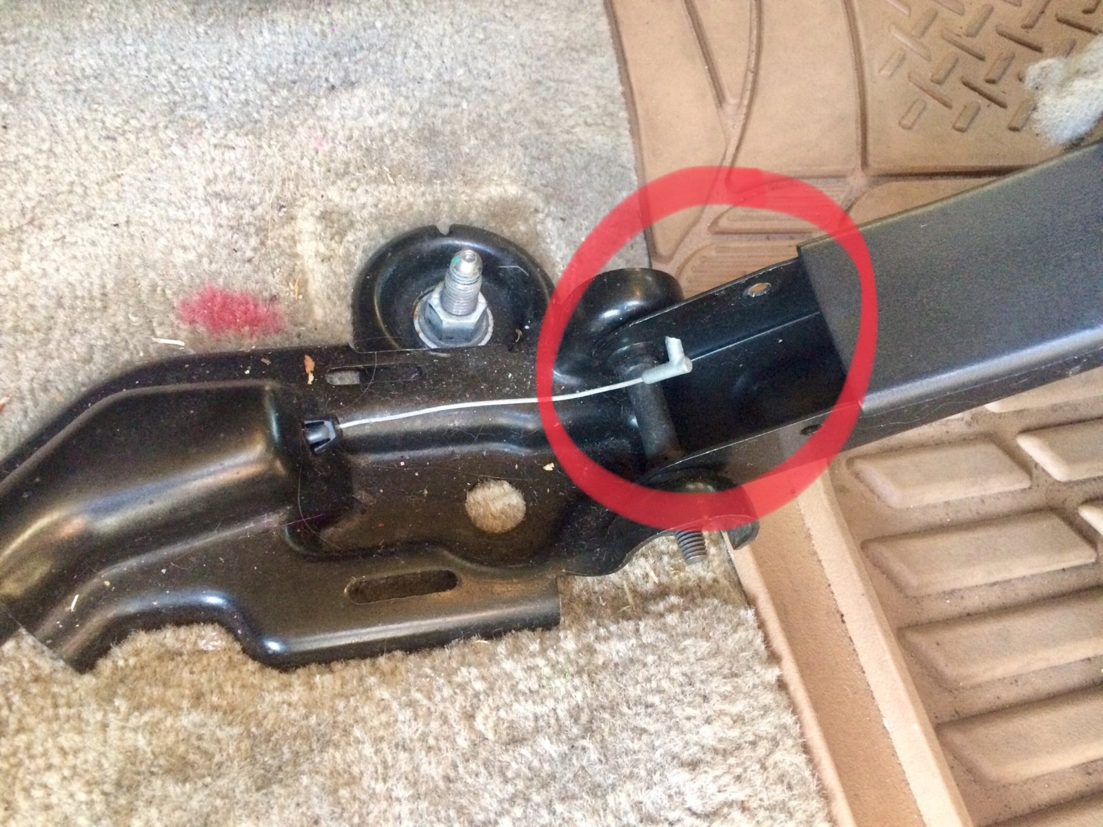

So, my Tahoe has no levers for adjusting how far it goes back. Took some additional photos in better light. I’m very mechanically inclined, but nothing really stands out as an obvious “ Oh this is the problem”. I do see a cable broke, and when in the upright position, it does not look like it seats all the way in the hinge. Have a look at new photos, I’ve marked up the two in question. Anyone know where I can buy replacement cables other than dealer? I’m headed to a pick apart today. 6E8A74CE-43DF-4B94-BBFD-6AEBEA2E82A6.jpeg203AC05E-9E4D-4177-AE4B-33FA8DC44E4F.jpeg416D6101-817D-493A-9C8A-09A7668E09CB.jpegE856B4C7-69FC-4229-906A-B21C1704F915.jpeg8492360F-EDC7-44B6-BB4C-18348B11E037.jpeg
