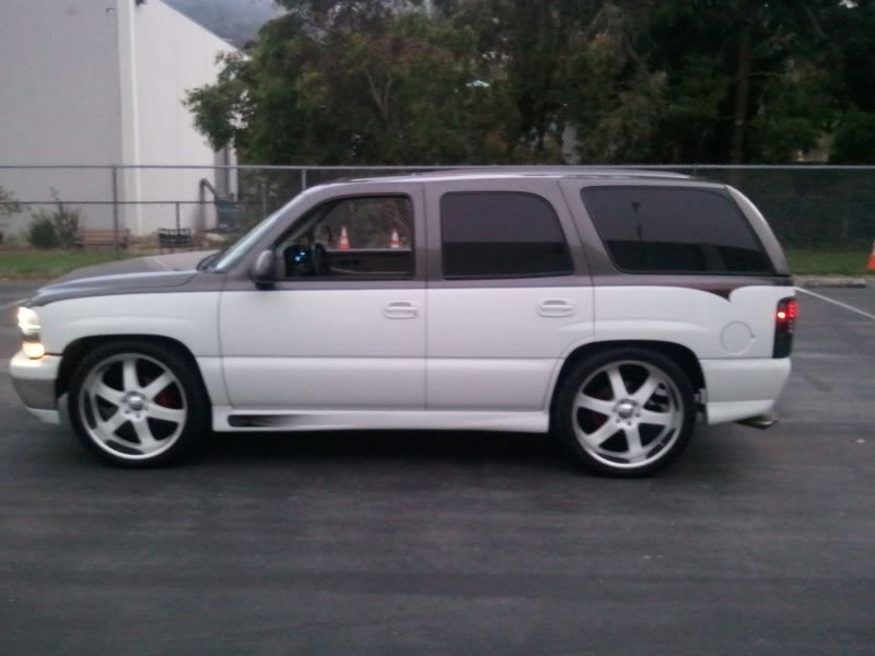

Mine was fine with 305/45/22's so you should be OK.
Hey guys, I'm new here and wanted to chime in. I too am going to order this 3/5.5 drop kit and mount 24's on an '03 Yukon, but was wondering what is the ultimate offset wheels to run.
Grocery getter's is the perfect example of what I'm after, that is a sweet lookin ride!

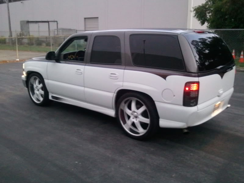

you can see the one ijust did a few weeks ago on 305 35 24 no problems at all. 24x10 with 30mm offset is what i woudl go with.

It's a 23' Malibu, not sure about tongue weight, but the ass end drops about an inch at the moment. I guess if the tires don't rub we'll be golden. I want to see some pics of the last one you did, do you have any?

he had another set up before i pulled everything off replaced it with the complete djm drop kit
305 35 24 tires and rides much better than his old spindle/keys/other brand rear 5 inch drop kit set up
