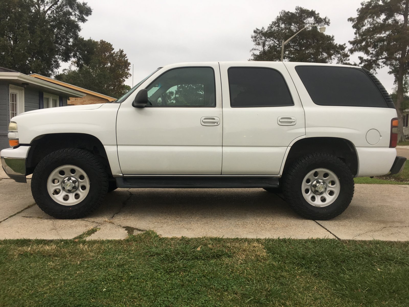

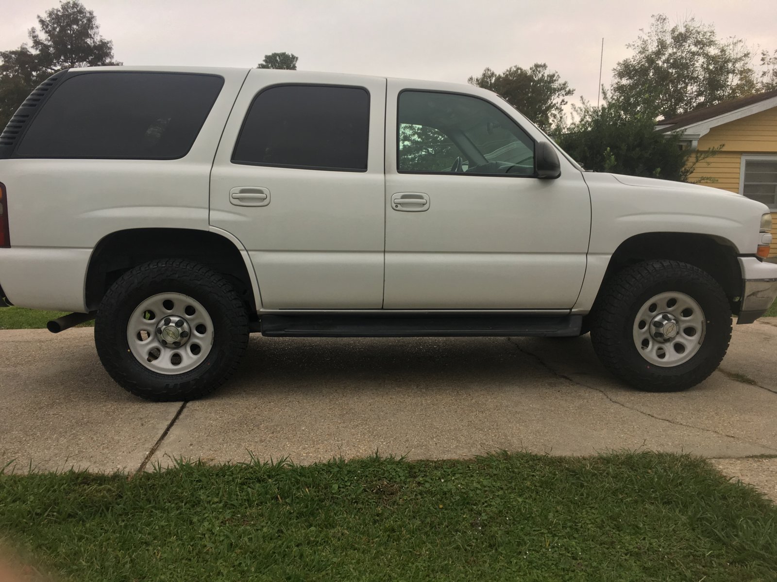

i have rcx keys with no spacer and fit 33s without trimming. no rubbing. and i kept my gears the same. does fine

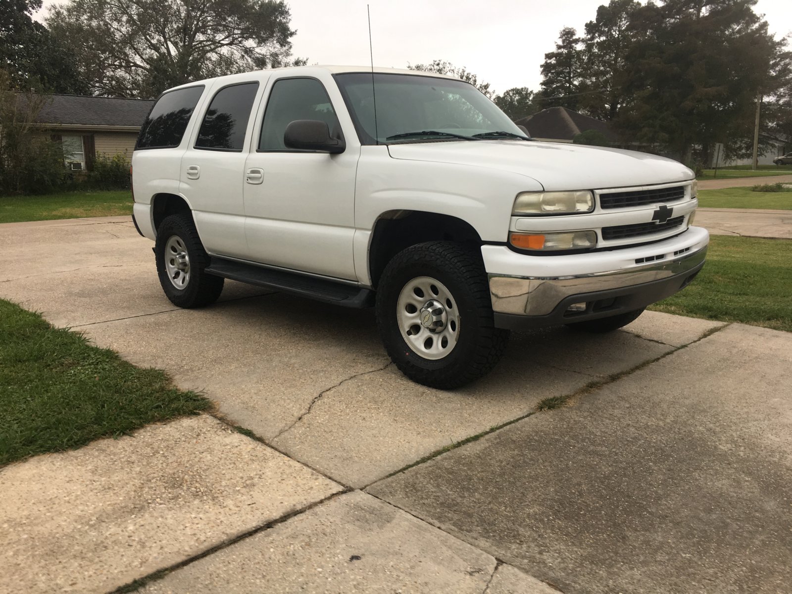

I have 2" keys on the front, nothing in the rear. I had to trim my front valance a bit and the wheel well liner on the driver's side as the tire lugs would catch it while in reverse. Keep in mind that not all 33x12.5" tires are really 12.5" wide (For example Atturo tires are narrow even though they're listed as 12.5"). If you get a real 12.5" wide tire you'll probably need to trim. It also depends on the wheel you'll be using, what its width and offet is. For reference, my wheels are 20x9" with a 0 offset.
Regearing, IMO, is not needed for a 33. The only "con" that I've encountered is the truck downshifts on pretty mild inclines on the highway (65ish mph).
