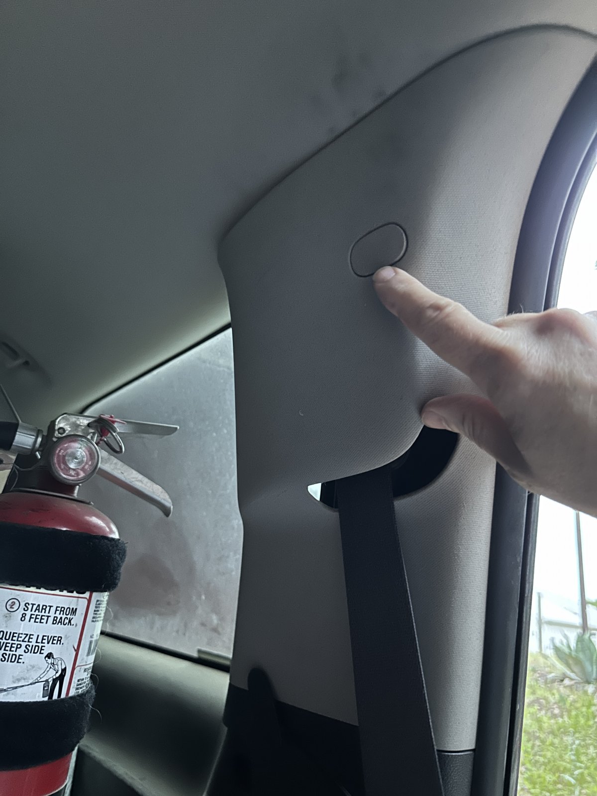

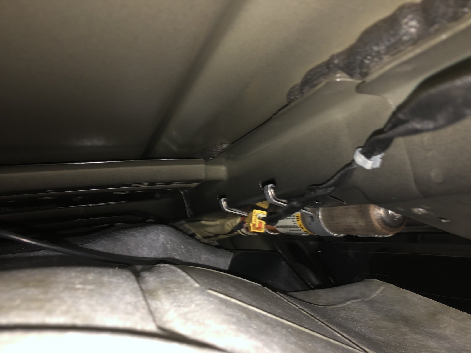

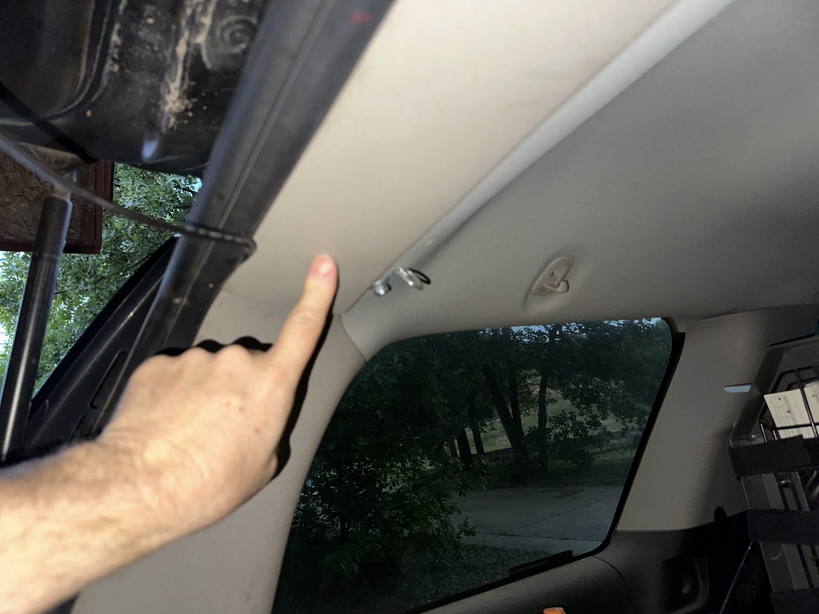

Neither the C or D pillars say anything on mine either, but the airbags are there. To physically check the edge of the headliner needs to drop slightly. You can do only one side for this exercise. The air bags are RIGHT THERE, so not a lot of movement needed to see with a mirror or camera.

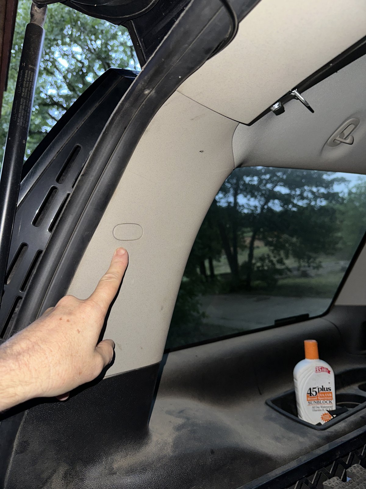

To get access, the rear trim just pops off. It's held on the edge by the weather strip. The coat hook has to come off too.
The D pillar cover has one screw under a cover.
The C pillar cover may need to come off too, if a little more wiggle room is needed.
It's right there nestled against the coat hook hard point.
