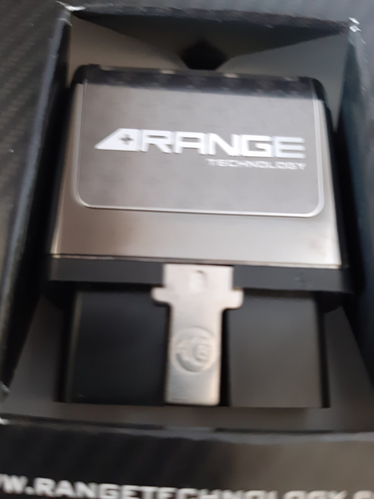

I purchased a 2013 Tahoe in Nov 2021, also purchased the Range Deactivater. Plug and play, no problems.
Purchase price was $214.?
I just traded the Tahoe off as I wasn't a fan. Well not as much as I thought I was.
Anyway sold Tahoe keep the deactivater. It is for sale not as I don't have any use for it.
$110 includes shipping.
Private message me .
