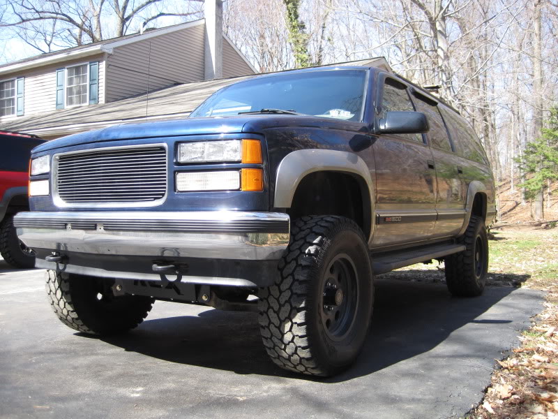

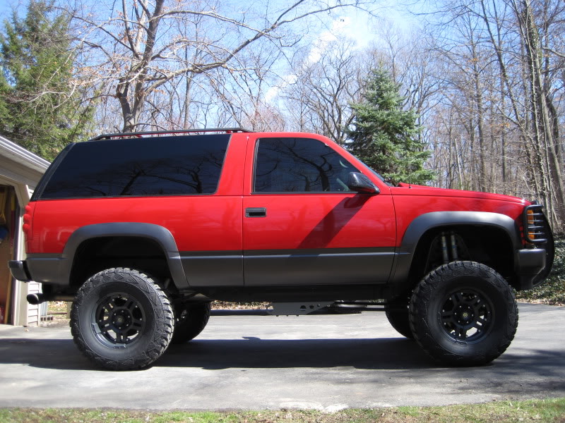

I am very pleased with my Rough Country on my suburban. Install is straight forward parts fit great too. I run the Cepek kit (extreme suspensions) on the tahoe and love it too, but the instructions were less than great with that kit. The Cepek kit is taller and I opted for a few goodies like the dual shocks. Heres a few pictures. Both trucks run a 35x12.5" Again the RCX kit gets really good reviews on many forums. Don't let the price scare you, I feel it is quality. and FYI, the 4 or 6" kits are the same just the 6" kit comes with an add a leaf. The kit even comes with brake lines (rubber ones)
The tahoe sits 2" taller in the rear and 3" taller in the front than the burban. Fender measure about 42.5 at all 4 corners on the burban. The tahoe has a little crank done and teh burban does not yet. The differential drop is about 1.25" more on teh cepek kit making it the biggest 6" kit for the OBS trucks. The RCX kit drops the diff about 5.125 or 5.25", cepek a true 6.5"
