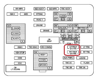

If the DS turn signal doesn't work either, check the in-cab fuse. Trailer circuit is fused separately. Sorry this diagram isn't going to be very clear, but the two fuses within the red circle are for the trailer brake lights and turn signals. DS is the top one in the circle.
I'd be interested to know if that's the fix.
