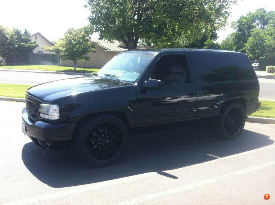

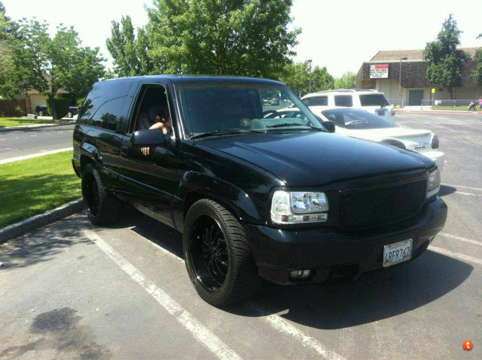

Yup direct bolt-on you need the fenders, hood, bumper and support, headlights and front turn signals, some kind of fender flares if u want them? stock wont work since u have a 2dr and the rear bumper would look great too

That one is one that used to be on here

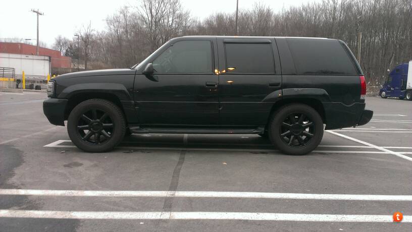

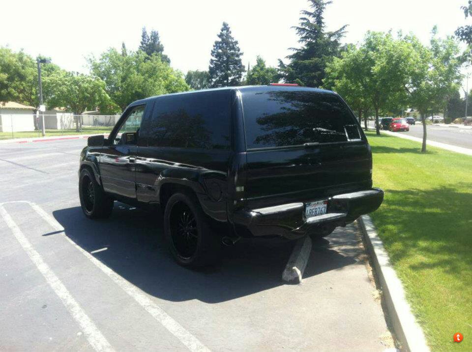

The flares and bumper are off a 99-00 Denali, not sure how he modded them to fit that 2dr was a member on here but sold the truck, mines the 4dr, you can do the front end and rear bumper and just get some aftermarket fender flares

Its all bolt-on only issue you will have is if you do not use the factory or some aftermarket front fender flares you will see some holes where those attach not a huge deal can fill em or use aftermarket ones front and rear
