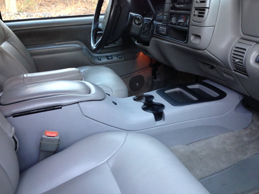

Anyone tried or had success swapping in the center console from a 99(ish) Escalade? I want to change out from the half way (stock) console to one that separates the cockpit into 2 sides all the way from the dash back. I've seen a couple people do it with modified F150 ones, but who wants a ****** ford part to sully up their ride, and I would assume the mount should be basically the same going from an Escalade into a Tahoe so it would be a lot easier.

Its done all the time using either the Escalade or Denali console from the OBS trucks. The mounting holes all line up and the rear mounting bracket is the same.
Search TYF's for sale section or Ebay for consoles around $150 to $400.
Search junkyards near you for consoles for around $75. To my knowledge(limited) no ones been able to get the consoles rear switches and electronics working but it does look good installed!
