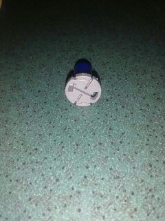

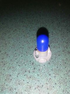

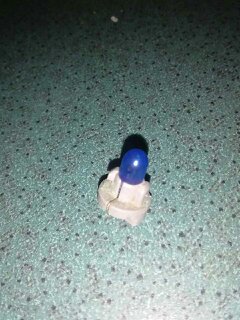

Can one of you post pictures IIRC I could have swore they were soldered I could be corrected tho :hmmm2:
97TahoeLT
Sep 8, 2012
102
Arizona
How many do you need?
97TahoeLT
Sep 8, 2012
102
Arizona
They are not soldered
