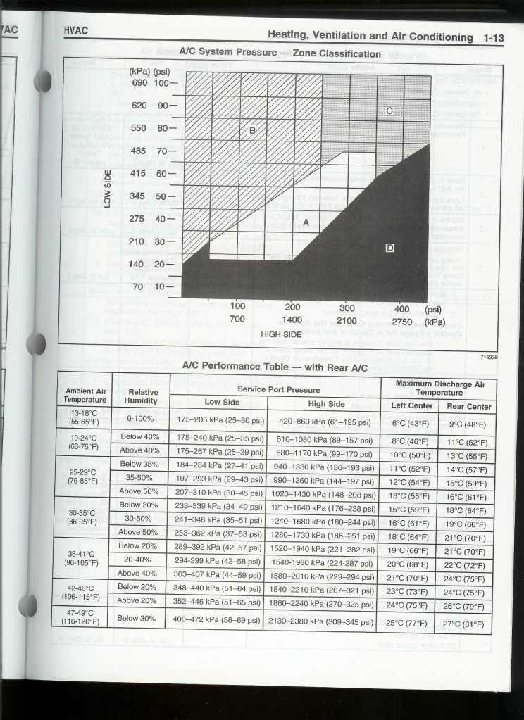

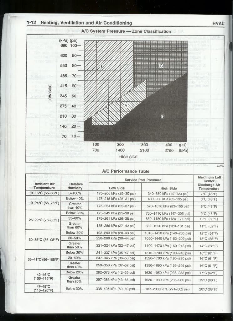

exact same problem I had last week. I bought a recharge kit with a gauge. Released the 134a......same thing, still not as cold as before. Gauge reads 50 psi on the low side. When I start the AC, I hear a growling sound from the dryer. It will get cold maybe after 10 mins of driving.
So I brought it to a shop. Low side reads 60 psi, which is too high. Normal range should be 30 - 40 psi. The shop vacuumed the freon out.......ALL 4 lbs OF IT!!!!! Again, it should normally be 2.7 lbs. In other words, I overcharged it !!!!
Freon was pumped back in and now my AC is as cold as ice.
