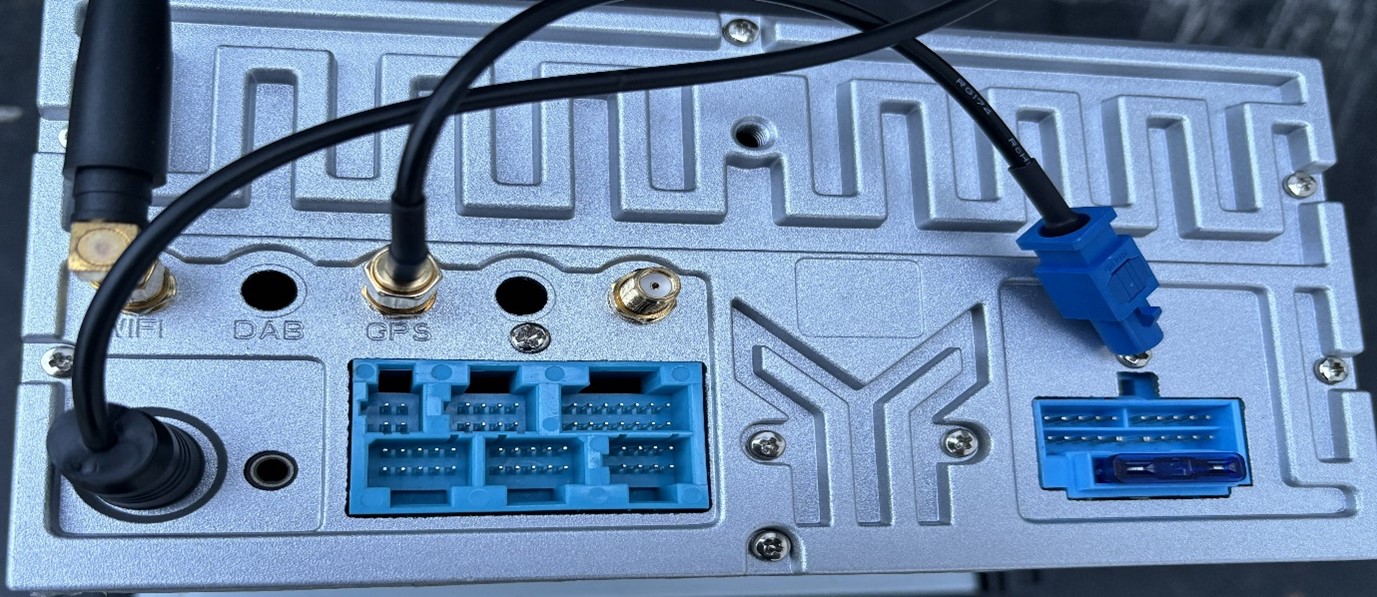

I would like to swap this standard car radio (2012 Silverado).
with this one:

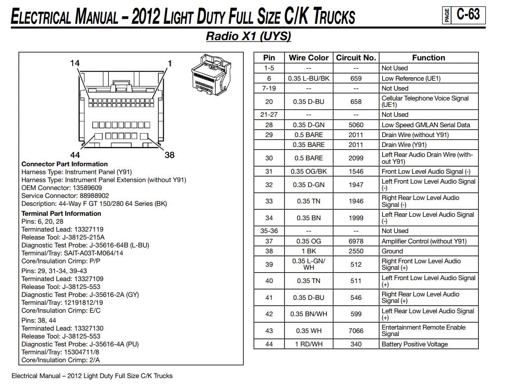

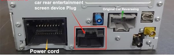

I haven't found the electrical manual for the "rear entertainment" and "car reversing cam" 20-pin connectors yet. Can anyone help me with that, please?
Q 3

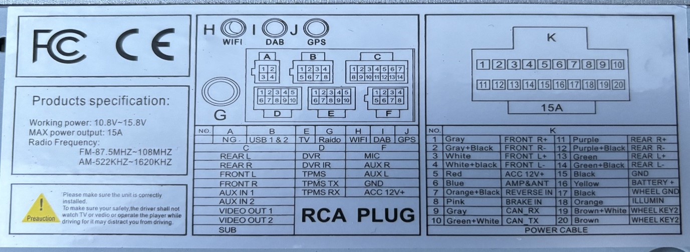

How do I connect the "OG car reversing" and "rear entertainment" with the Android radio, if it is even possible? I have all the needed harnesses ready. I just need to solder the correct wires together i guess. To be honest, I've never installed an aftermarket radio before and I'd rather not make any rookie mistakes. That's why I'm asking this question here first to save myself some headaches and precious time.

My recommendation is to contact Crutchfield by phone and see if they can get you an adapter that will allow you to simply plug and play the new head unit's connectors to the truck's OEM connectors. This will preserve all current head unit functionality (including steering wheel controls, and rear entertainment functionality). No wires to cut/solder, etc.
