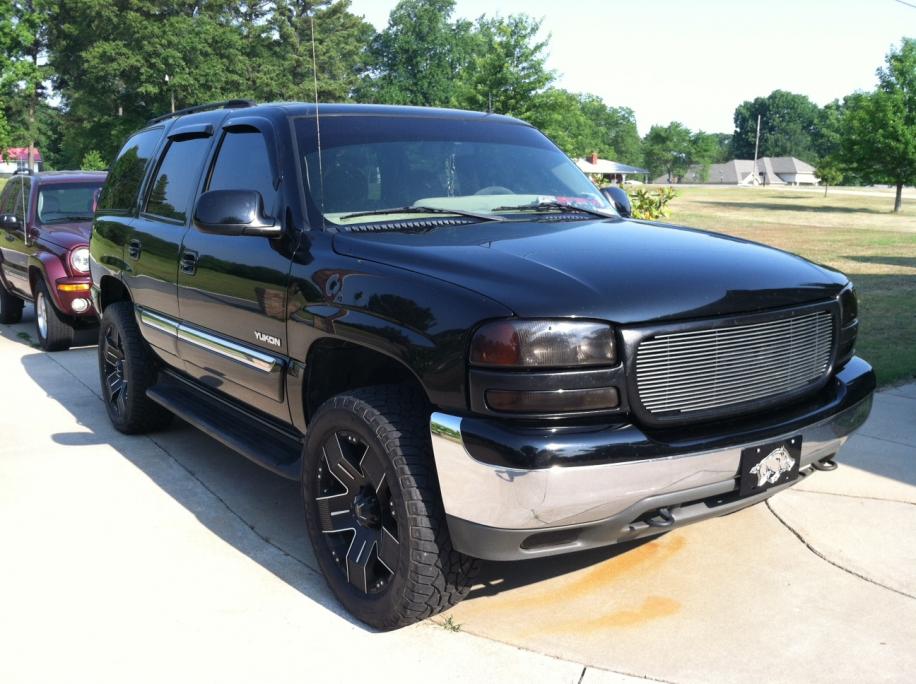

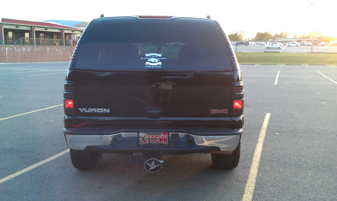

I recentley returned home from afganistan i am from arkansas, Currently stationed at Ft Hood Tx. So after i took alittle time off it was time to make the trip back in the yukon. 683 miles to be exzact. It ran really well until about 200 miles out from my destination. Fuel pump went bad had to leave it at a local shop where they replaced it and picked it up the next day $580 repair. Monday i notice that there is alot of grease on my front left inner fender. After looking at it for a few i noticed that the cv boot is busted so bought a new axle shaft from advanced auto currentley waiting for it to be installed. She now has 234000 miles. I know it is time to change the fluids. My plan is to flush and replace tranny fluid filter, radiator, brake fluids. Are there any more? Can i do any of these easiley? My next step is to start saving for a new motor and tranny i know its coming soon. Both seem to be holding strong(knock on wood) But hopefully these is not a trend of things to come. I do not want to be constantly replacing things. Yes i do know it is a very high mileage vechile just havent decided to sell or keep it, it is paid for and my only means of transportation rightnow except for my wifes cars she is back in arkansas currentley in school. I do really like it so i guess ill try to hold on to it for awhile longer. Any help and thoughts would be helpfult thanks I attached a few pics of what it currentley looks like
