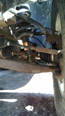

kpachastings
Jun 2, 2014
18
wny
I will try and get pictures of angles after work

kpachastings
Jun 2, 2014
18
wny
When tires were New and without wheel spacers
