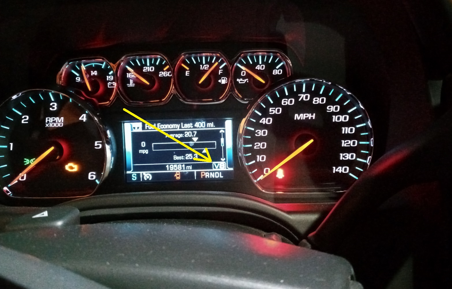

You can go to the screen on the DIC in the middle of the gauges that shows the MPG readouts and down in the corner it will show V8 or V4 mode active. The Range plug in disabler works fine on these machines. Son had a lifter making noise, scared him, he put some Sea Foam in the engine and got the Range device and it's been perfect now for 20K miles or so.
