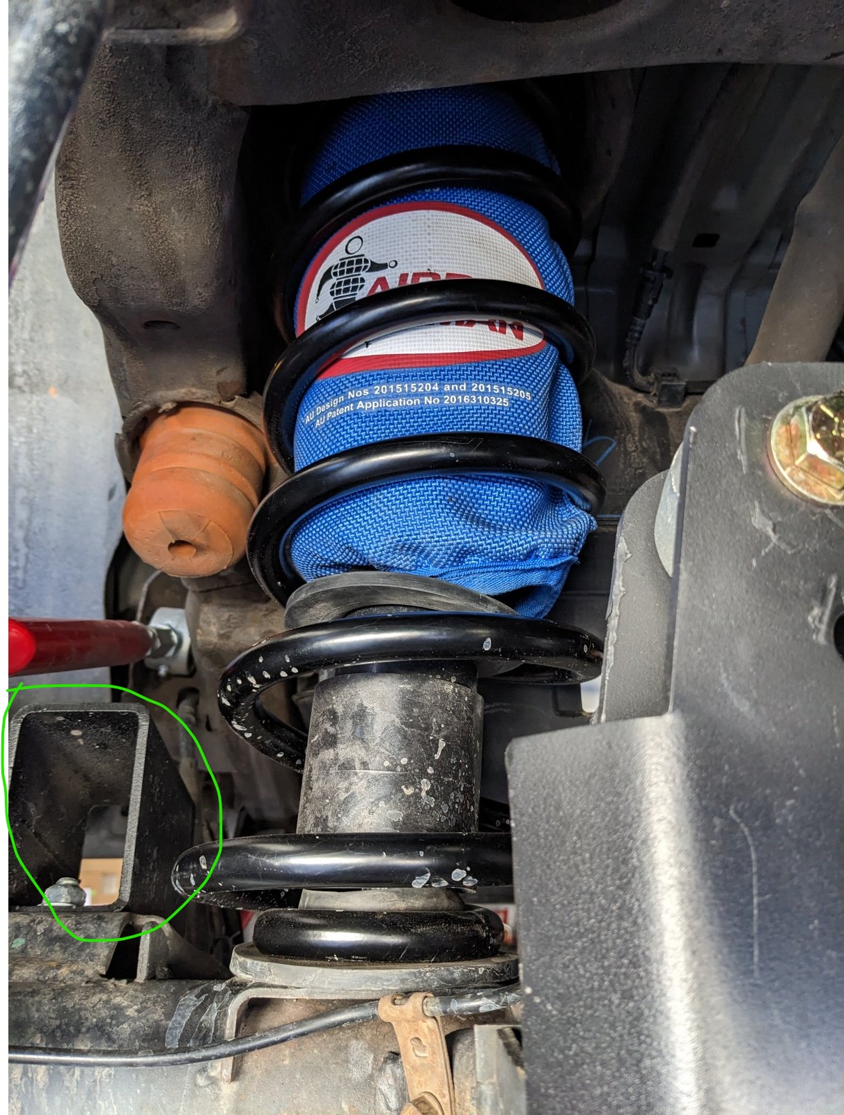

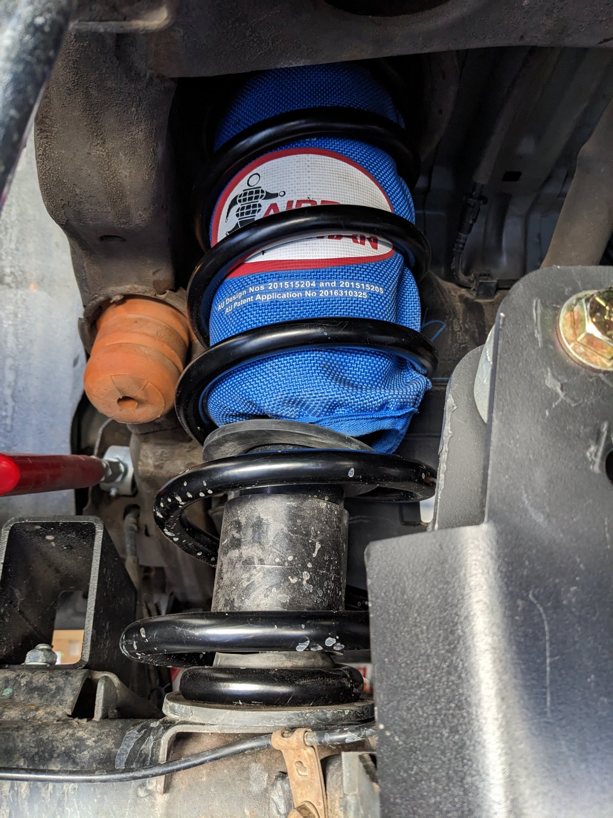

I use air ride air bags in mine. they do fine off-road although they tend to loose air, and I have had the air hose pop off one of the bags before. I am using 2" lift dobinson springs. Just order the air bags that fit your inner diameter and lenght of your springs.

Thanks!
I was wondering if a hose pop-off would occur.
