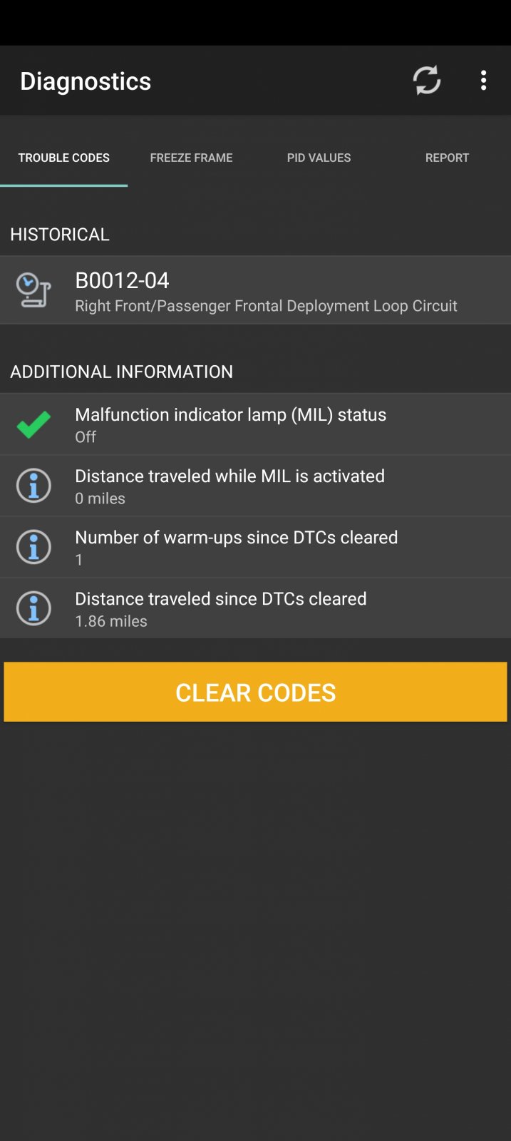

Yesterday, randomly, the airbag light illuminated itself.
Originally when I scanned I got a B0012-OD code.
And the 2nd time I got a B0012-04 code.
The scanner says the codes relate to the passenger side airbag, but the internet suggests it's drivers side....
Has anyone got experience of this, where do I start?
In case it makes a difference, the passenger airbag was replaced under the recall about 6 weeks ago... No problems until now.

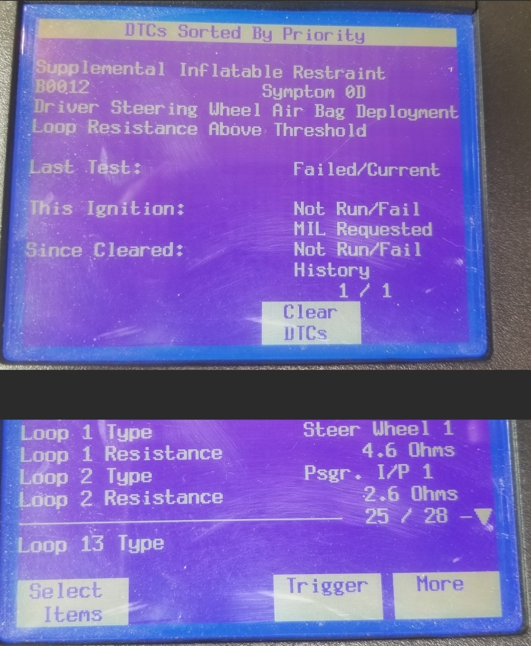

I had an airbag light a short ways back, code was for drivers side. The remedy for mine was removing the wheel and clocks clockspring wire connections and re-seating them.
I re-seated the airbag connection first and put back together, light came back on.
Tried again but re-seated airbag and clockspring connections, light hasn't been back since.
The code was for a high resistance and could have been a loose or slightly corroded terminal but all looked clean.
My code was B0012
