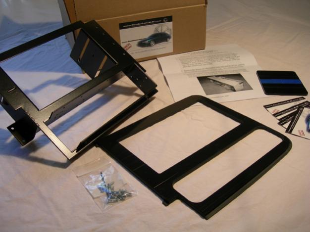

i just pre ordered my DD install kit From the detail SS about a week ago if thats what your asking?

where did i find the website? and i ordered the do it yourself one but im starting to think to change my order to the already completed one

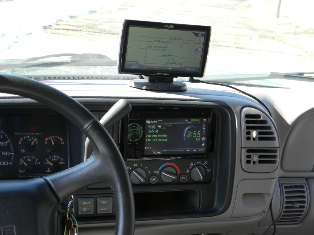

This is my current setup, basically cut the bar between the stock radio and the climate controls out, trimmed above as needed:

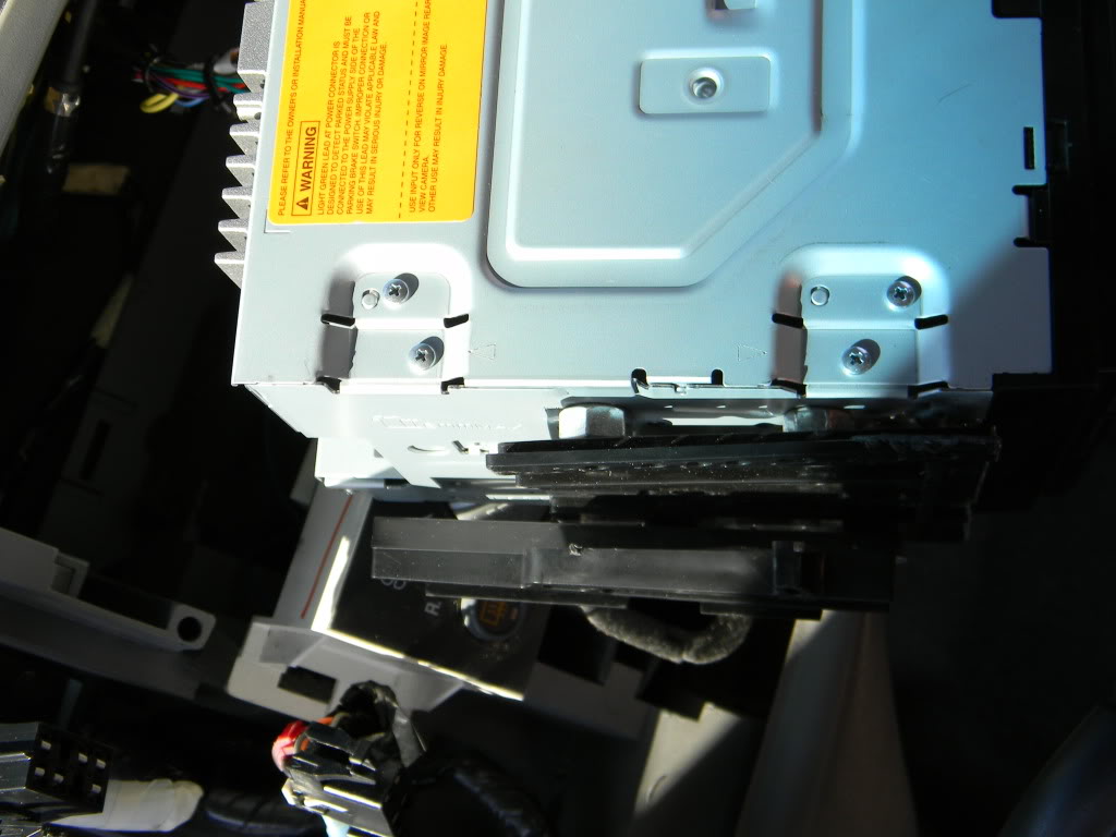

Used the Wal-Mart install kit, Scoshe iirc, hacked it to pieces and used the side rails and some nuts to fill the gap between the radio and the dash mounts:
How it fits: I don't have any pics of it finished cause I moved soon after I did this and haven't completed the dash, but I will post as soon as I do it.
