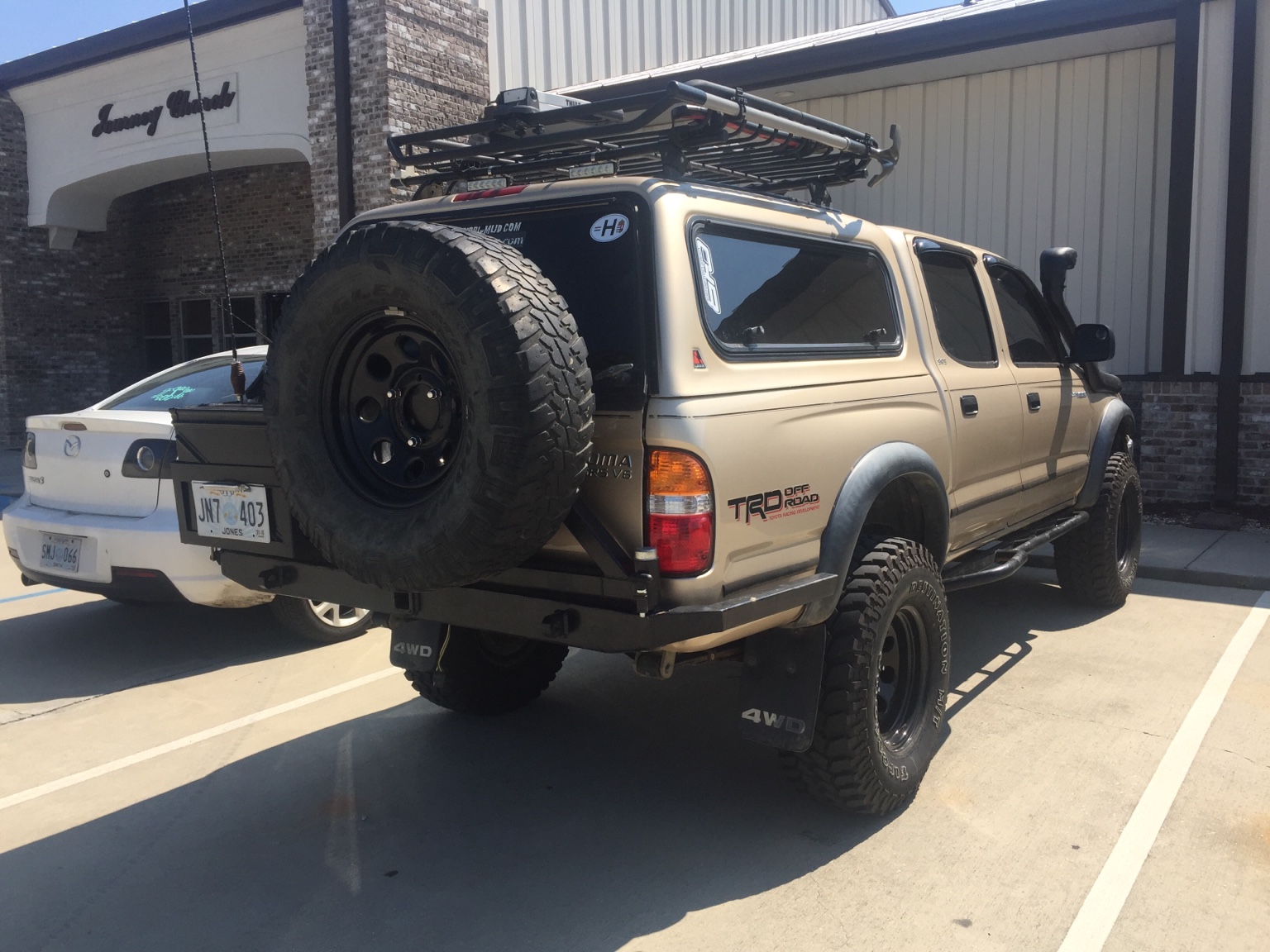

Hey guys. I'm looking at buying an 01 Tahoe this Sunday to become my daily driver. Currently my 01 Tacoma is my daily driver so the Tacoma will become an off-road and camping specific rig while I rack up miles on the Tahoe. Here's the Tacoma.
