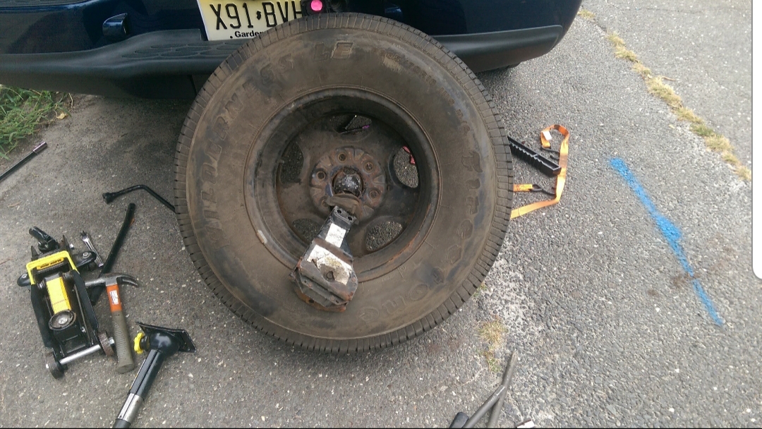

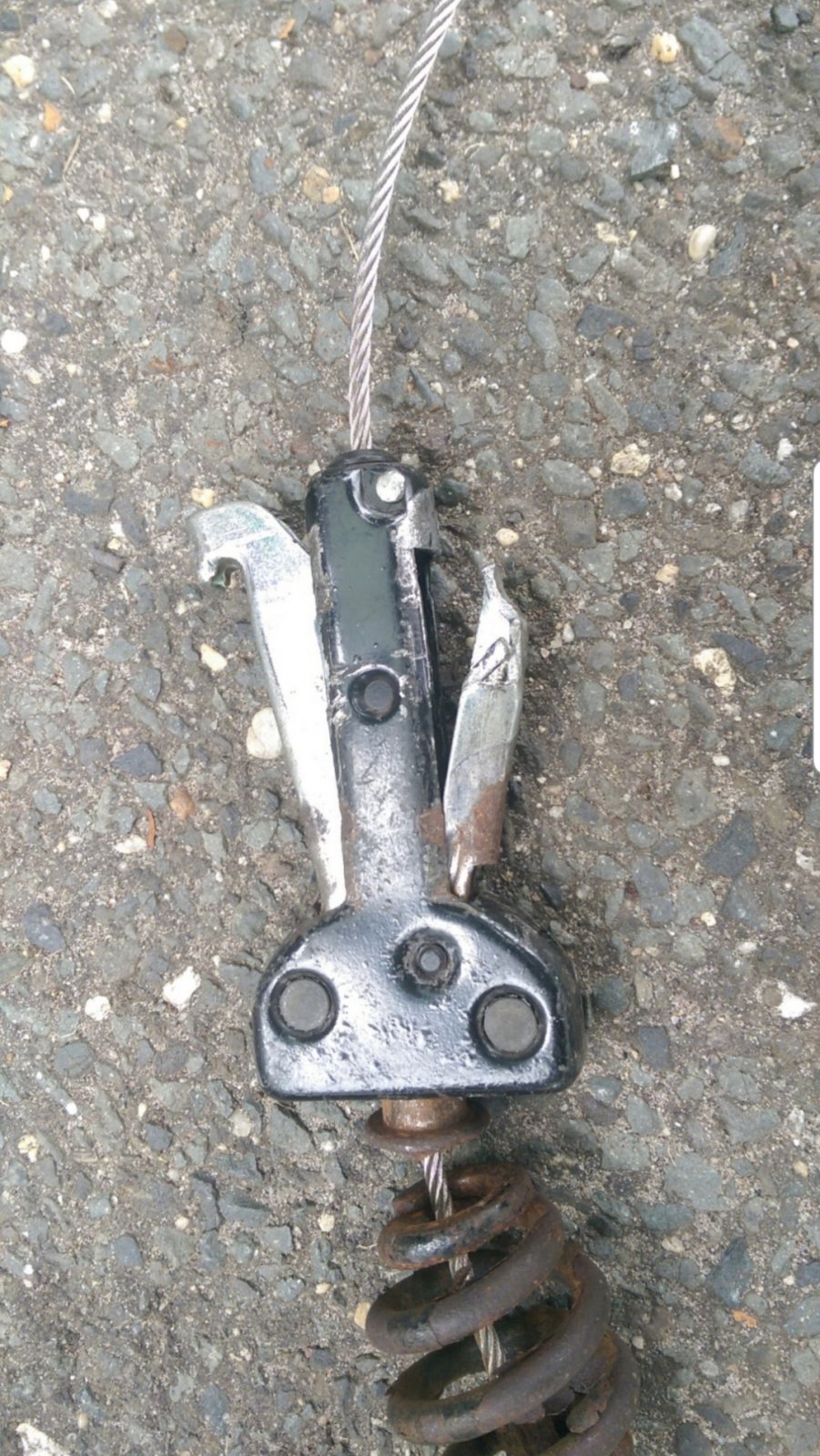

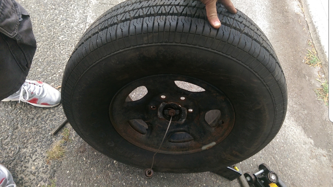

It's been a few years since I've done it, but as far as I remember there’s only 1 bolt that holds the hoist to the underside. Have you tried jacking up the rear-end and really looking under there? It'll help you if you also use some jackstands. I guarantee you'll find it. 20200727_191259.jpg20200727_191331.jpg20200727_202534.jpg
