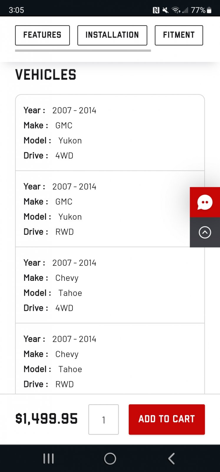

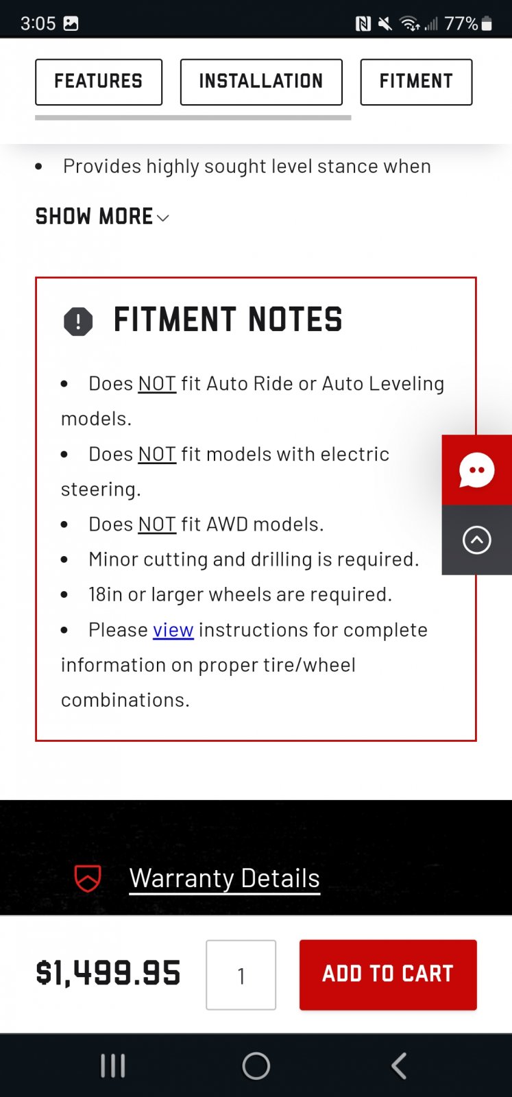

Hello! Hope no one minds me making a quick thread here. I cant find one that pertains to my exact concerns. This is my first time doing a full suspension lift and my first time joining a forum. I have a beautiful 2007 yukon denali and i am looking at rough countries affordable 7.5" lift. My concern is that through the website the lift kit that is marketed for my vehicle says that it does not fit my vehicle. I will attach photos of what the page is displaying with my vehicle info inputted. But ive seen a few examples of what I beleive to be my exact vehicle with this exact lift. If I had to take a guess... it says that it doesnt fit my vehicle due to the autoride. But it also claims that it doesnt fit AWD vehicles? But says it fits 4WD. I believe mines awd do to the inability to put it into 2wd? Am i over thinking this? Is this gonna work for me? I understand that there will be some cutting and what not ive watched a few installation videos but im concerned that maybe mine is different in some way?

alright well... here is what i have learned with upwards of 10hrs digging around. The reason why is because the lift kit creats such a lethal angle on the front driveline to be running at high speeds constantly it is a terrible idea to lift the awd yukon. I have found a 6" lift kit from procomp that does claim to fit my awd denali and it does include a dual cardan driveshaft. The main concern with this being made possible by a driveshaft upgrade is that the risk is still too great. I keep hearing of situations where people have lifted their awd yukon and upgraded the driveshaft. But about half say the vibration is too much and the other say runs smooth on the highway. So i give up and will likely sell the yukon as the conversion to a 4wd is not worth the hassle. I am still curious... to anyone who has 6"+ lift on an awd yukon... hows it ride and where did you get your driveshaft from
