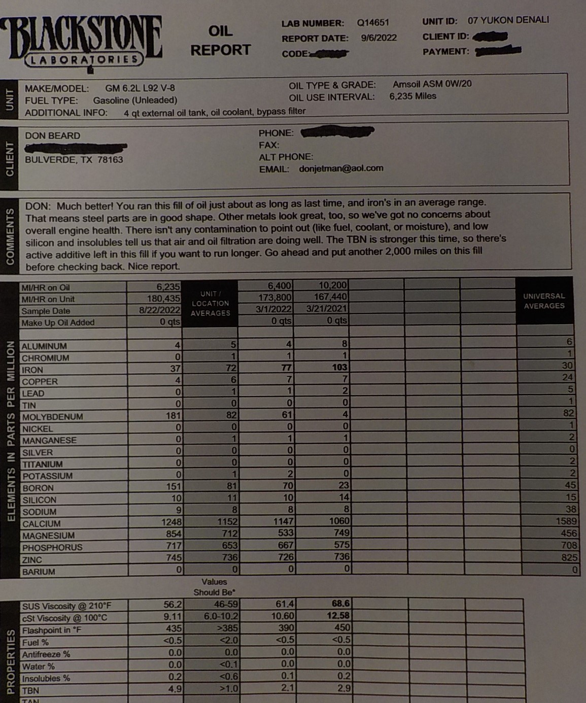

I've been an Amsoil preferred customer since 2009. Amsoil and HPL brand oils IMO are arguably the best oils, but they come at a $price$ IMO if you're doing normal oci (oil change intervals) don't waste your $$$. For xOCI (extended oil change intervals) these super premium oils make $cents$.
I'm currently running Amsoil (for the first time) Sig ASM 0w-20 in our 07 Denali w/6.2L and 180k miles. I recently did UOA (used oil analysis) at 6,200 miles on the oil and all was good, so I did not drain it. I will send in another sample at about 10k miles. I did change the Fram Ultra XG10575 oil filter because I wanted to cut the ole one open to see what is what. All was good with it too. I'm getting improved gas mileage with the 0w-20 versus the 5w-30 and 5w-40 I've run in the past
*NOTE* I have increased our Denali's oil capacity to 11 qts, added a small oil cooler, an engine oil bypass filtration system, and a 180* thermostat.
So, your results may vary.
