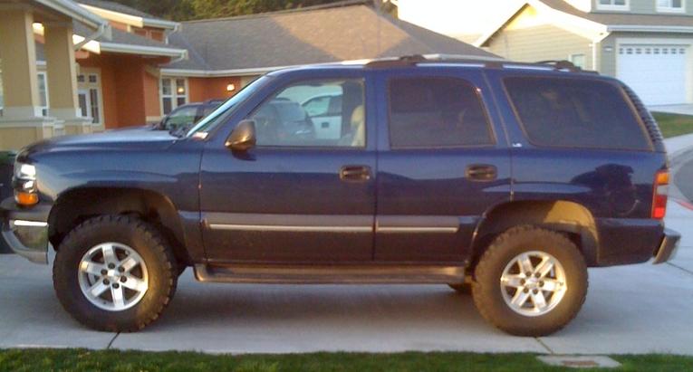

you dont need the BL, spindles keys and spacers will clear 35s. If you ask Brandon nicely he might post some pics.
Yes Brandon has been quite the help:Handshake:

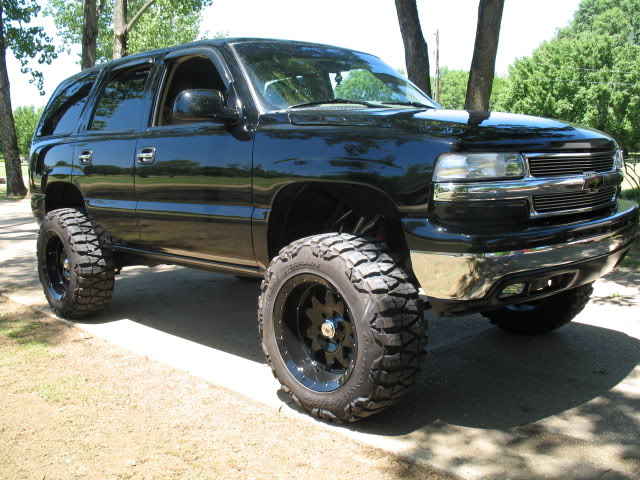

35s on 20x12s 3" spindle, 2" keys, 3" spacers in rear
Same setup with 1.5 bl on 35s 22x14s
Here u can see the spacers an shocks. All u need
