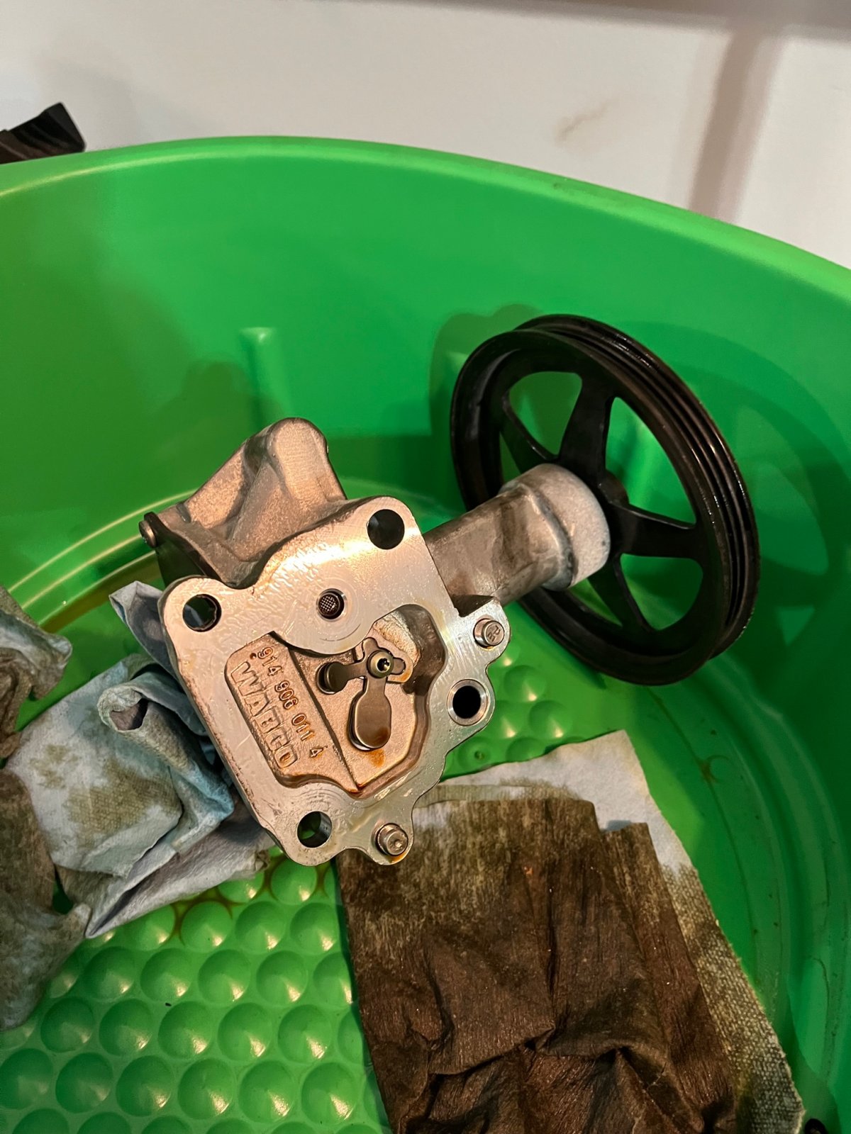

Shark Fin- can't help ya much there. I don't use Sirius and personally really want to delete it as I don't like the placement location.
Vacuum Pump- if I remember correctly there's an active recall on these that includes your year model. After learning of the high failure rate that these have, their potential catastrophic engine damage, they aren't used on Corvette's/Camaro's, I elected to perform the delete mod. Let me know if this interests you and I'll provide more specifics from experience: engine block plug kit, vacuum source, etc...

You have more than 150k miles? The vacuum pump should be under special policy.
