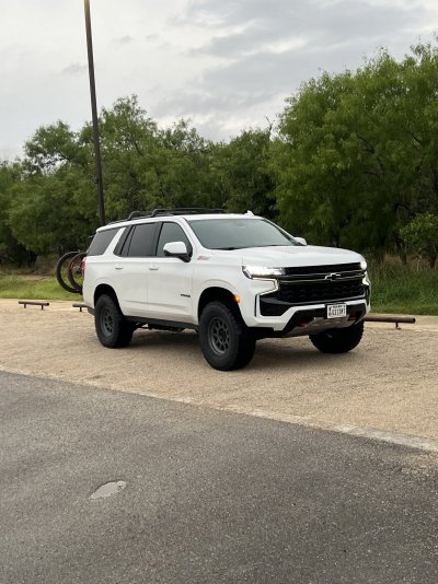

Took the leap last week to see the limits of sensor trickers from Edgymod or Switch Suspensions. All I have to say are great things. I am currently running 35x12.5x17s on my 2021 z71 Tahoe and they don't rub with fender liner trimming and removing a liner bracket that is only used to hold one fender liner bolt. (no cutting) I have them set to 2 in the rear and 2.5 in front and with the big ass tires, it rides like stock. Yes I know maxing out this and messing up the bags is risky but it's worked for a solid week. Nothing but smiles so far!

I installed mine myself and it took about 15minutes so no experience with shops lifting it. Where the sensor side is make sure to get the lips of the socket thing fully around the ball, takes some spinning and angling but that's how it is most secure and for the non-sensor side just push it on really tight and don't worry about the lips. You will have to almost max it out to fit a tire that big. (I'm almost maxed running a 315/70r17) and if you are okay with maxing it to fit something that big you will need to trim liners and also take off a liner bracket that comes off with 4 15mm bolts. Let me know if you need more help!

Here are some pics!
