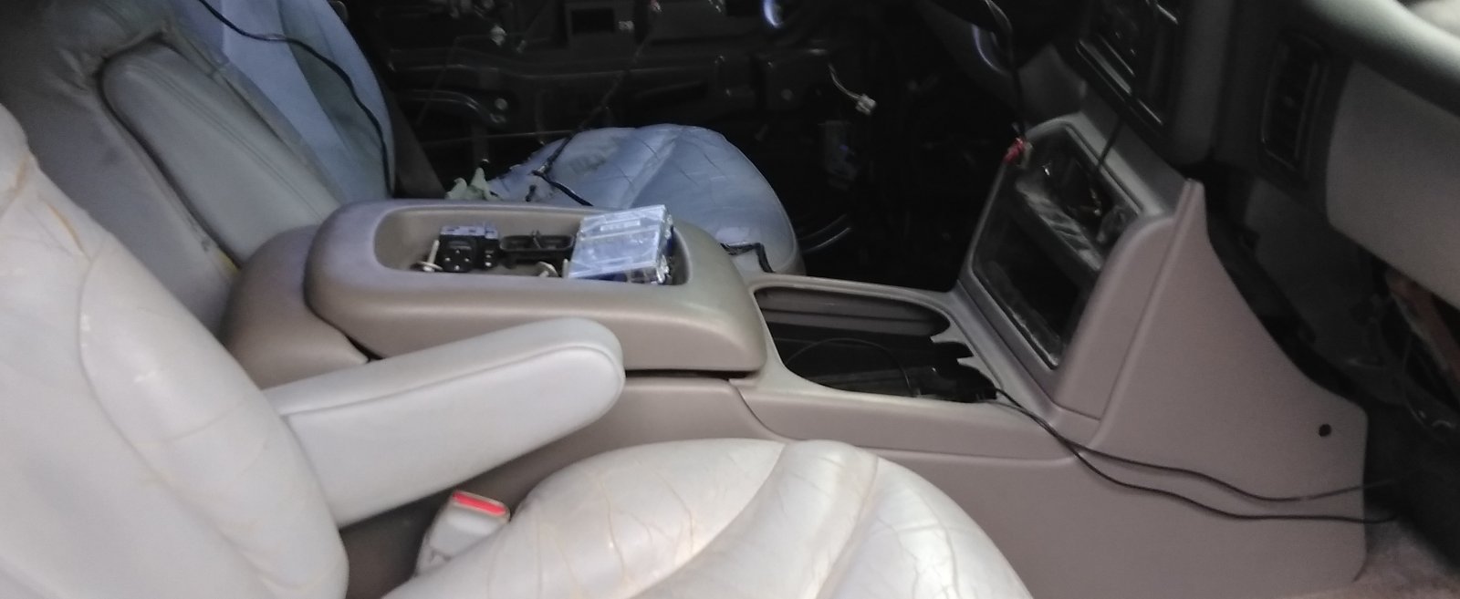

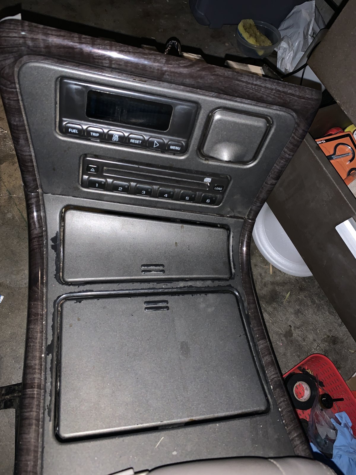

I swapped out my 2001 yukon xl center console for a 2004 tahoe console and been slowly redoing the whole interior
First is old of course only shot i have of it.
This is the new from an 04 Tahoe easy swap just got to make sure you have all mounts and supports also the newer lower dash panels for under column and glove box as they are a little different.

I didn't think I was so easy, yeah this is awesome. Will absolutely do your mod. Maybe finally I can sit like a human and look cool instead hanging like a bad apple. :)

@M123 not a problem just dont forget the one thing i did lol. The black bracket that is under the dash to the console also you might ha e to drill one hole for that bracket to mount but its almost all plug and play.
