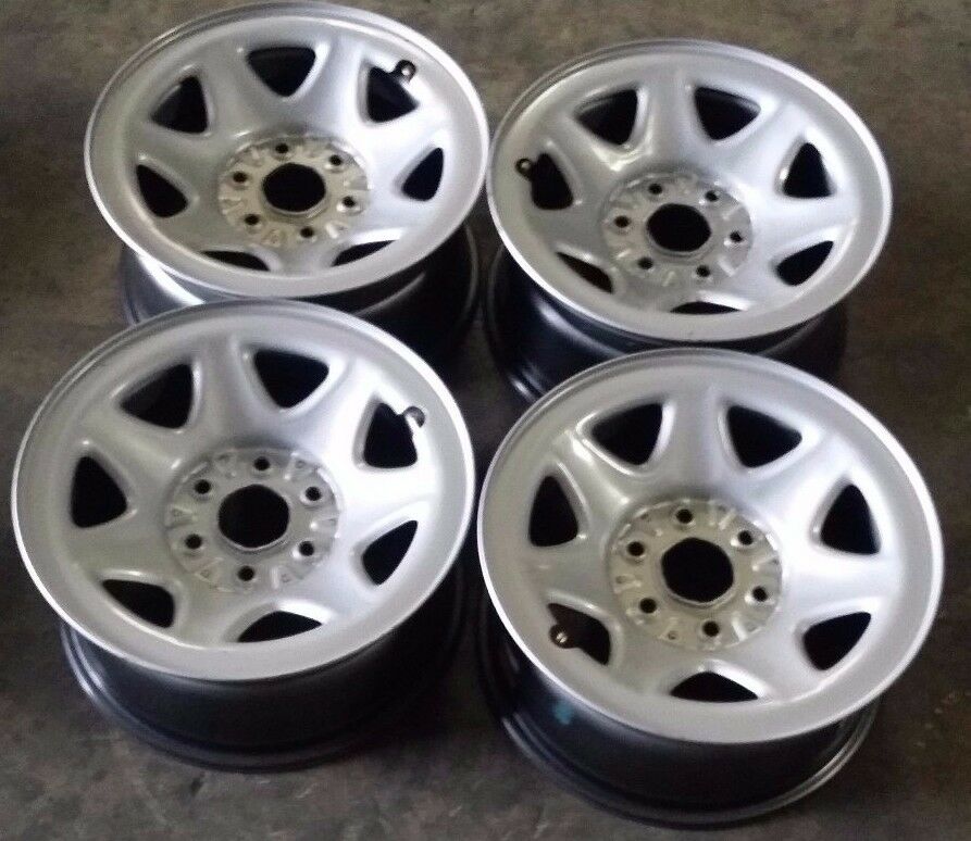

Any problem running these 17 X 8 wheels on my 13 suburban?

If they are OEM for your truck's year, I would not think that there would be an issue. You should check the offset for these wheels and confirm that they are the same or close to the OEM offset for the wheels for your truck.

From what I can see they will fit without any issue. The offset on them is 24 mm vs the 31 mm on the 22" x 9" wheels I have. They are 17" x 8" so with a 1/4 less offset and being 1" narrower they should fit just fine. going to grab them in a bit. Now I just need to find the correct TPMS sensors.
